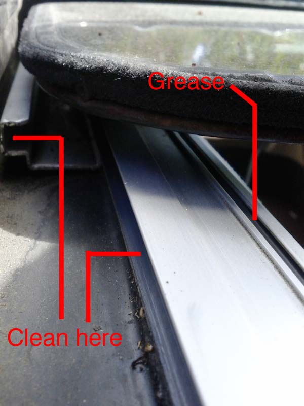

Re: L300 Sun Roof Slow
The cables, whether they run in aluminium or the copper coloured tubes, should be greased. It's unlikely that they are gummed up though, they don't experience much friction and are fairly well protected from dirt.
The sliding channels should be cleaned and lubed with graphite.
Here, I made a picture, though I left the glass in place:
- DeliRoofChannels.jpg (63.56 KiB) Viewed 4028 times
