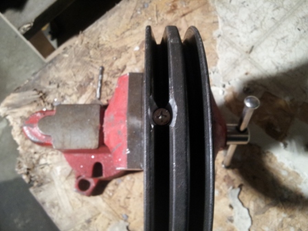

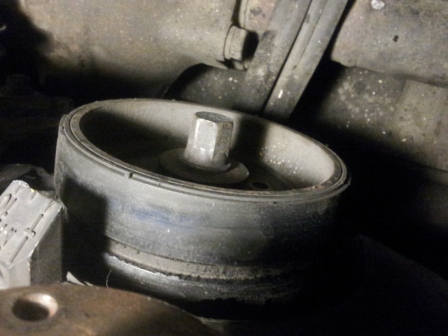

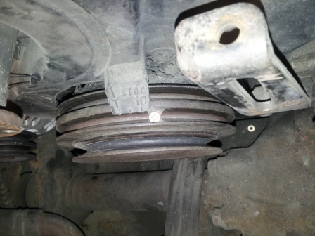

Pretty sure this is not an Mitsu Approved Repair but I managed to Temporarly Pin the Alt Pulley back to the crank pulley(Harmonic balancer) with two countersunk screws 180 apart.Put Everything back together and were on the road again!!
I thought it would be grossley out of balence...and maybe it is...but so far no squealing or noticable change in vibration....

I would still be inclined to swap in another on... The vibration it balances are small harmonic ones that can build in the rotating mass on you....not the vibrations you will fill, but the ones that could cause cracks and failures in the crank (at least that is my understanding on what it does, but I have been wrong before)

Thanks,Yes I know its Temporary..... I am Definetly am not leaving it like this!! I agree with you 100% its now out of balance and the screws are now most likley bypassing the isolator function of the rubber and transfering Vibrations...Also the timing mark has moved since its on the Alt pulley (If i remember correctly).I just purchased a parts van and am on the way this afternoon to pick it up.Hopefully it has a decent harmonic balancer or I will be ordering a new one.
