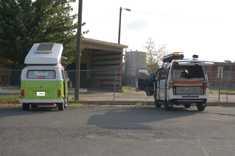

Picked up a very sweet Autohouse hardshell rooftop tent from a retiree in Qualicum Beach. My Westy conversion is almost complete!
The amount of space inside is surprising; you can actually stand up inside. The tent is self-popping by a pair of gas shocks, has a 3" mattress, and the roof is insulated.
Showing my Westy interior. I think I want to permanently install the ladder on the back hatch as the largest opening for the tent is there.
