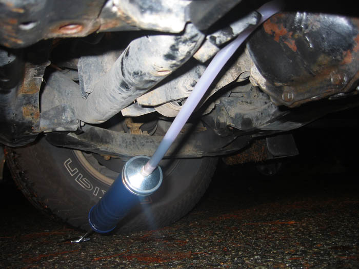

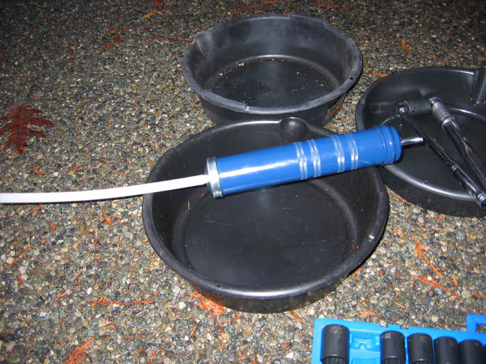

If you've done 40K kms without changing the diff oil then you're well overdue, especially if you've been four wheeling. Front diff is awkward on the L300 but doable. Remove the belly pan, remove the filler bolt, remove the drain bolt and let it drain. Clean the metal shavings off the drain bolt. Replace drain bolt and fill until the fluid comes out the filler hole. An automotive suction pump helps alot as the space is really tight. See attached pic. Don't overtorque the bolts putting them back in. Torque filler bolt to 49Nm and drain bolt to 59-64Nm. Cost of fluid is about $15-20 depending on which brand you choose. Hypoid gear oil, GL-5, 80W, 0.9L. 1/2" drive large metric sockets, a breaker bar, and a torque wrench required. Good luck!

Yah diff oil is easy to do. Drop the skid plate and loosen the drain bolt. The thing I advise is picking up a plastic hose/cap for the oil bottle. 6$ at can tire. Lets you squirt the oil into the filler hole easy.
