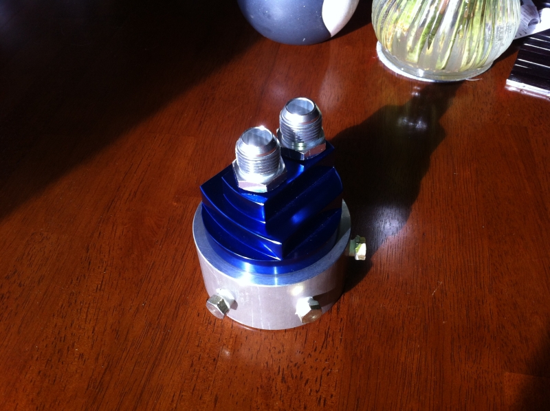

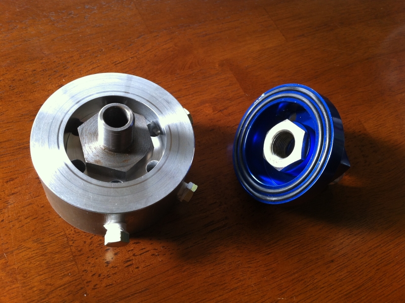

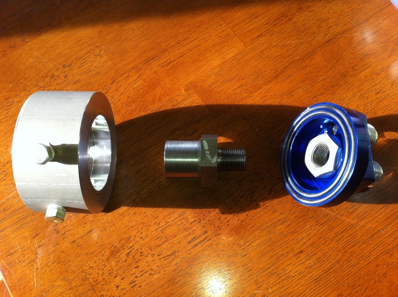

Here is the Adapter:
The Adapter
The Adapter

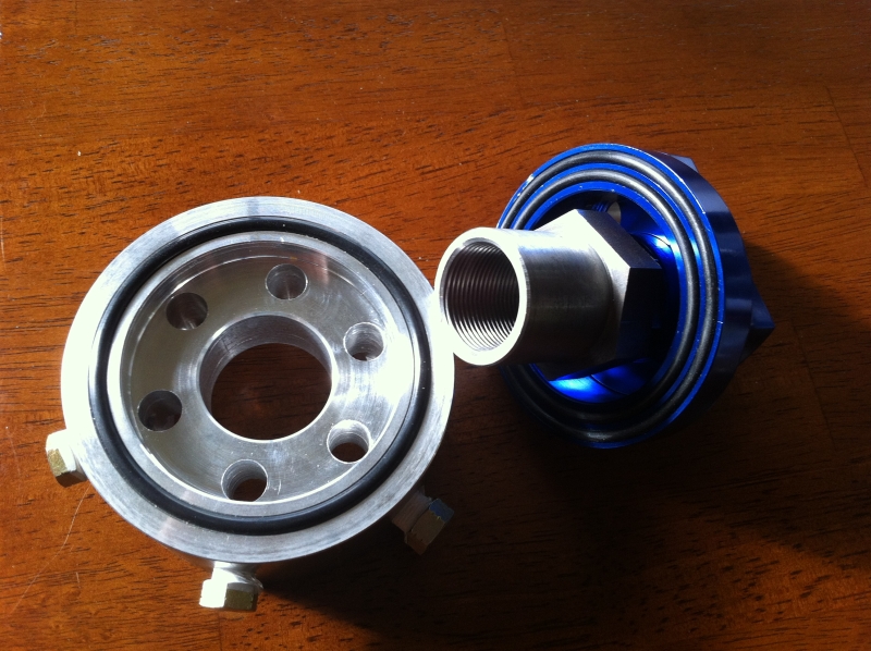

The exploded view:
Exploded view of the parts.
The engine Side:
The seal that goes against the engine side. Note the side ports I requested to be drilled in are the brass bolts.

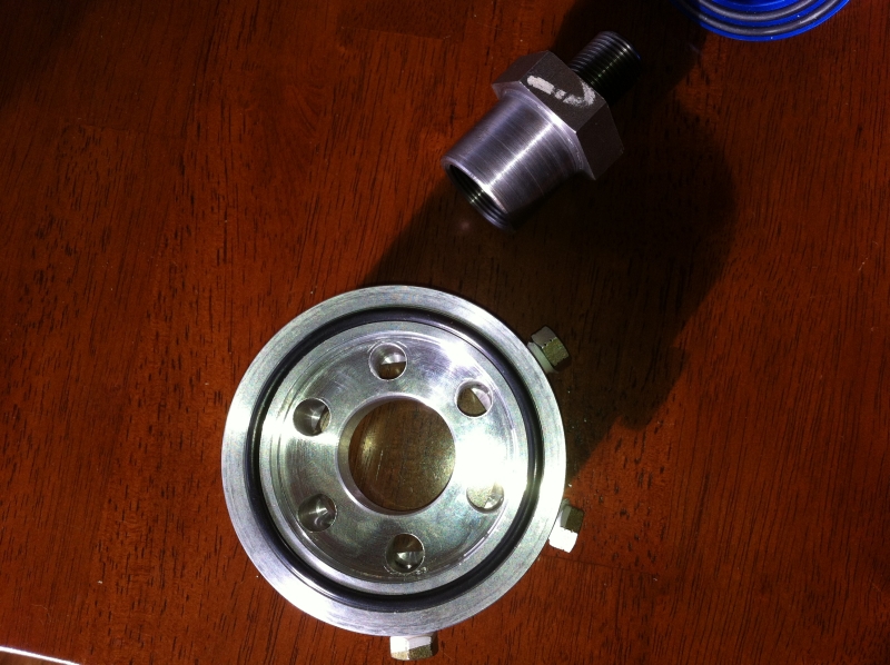

The seals on each part:
A view of the seals on each part. Note that for assembly purposes, the Aluminum engine part is upside down relative to the blue anodized oil filter relocation part.
The middle piece just "drops" in the engine part. It appears to be steel. It is the part that screws onto the engine, but it does not directly mount or screw into the large aluminum block itself. It just sits there freely. It is the attachment point to the engine itself that will hold the whole thing on, which is why it is probably steel.
The steel middle
The steel middle

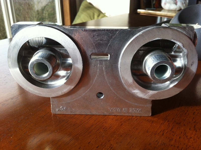

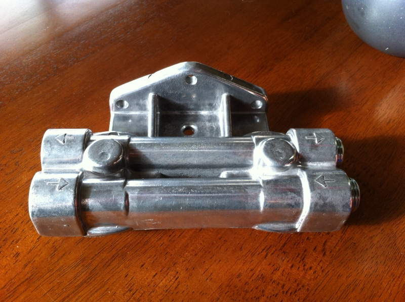

Here is the remote filter:
Remote Filter
Remote Filter

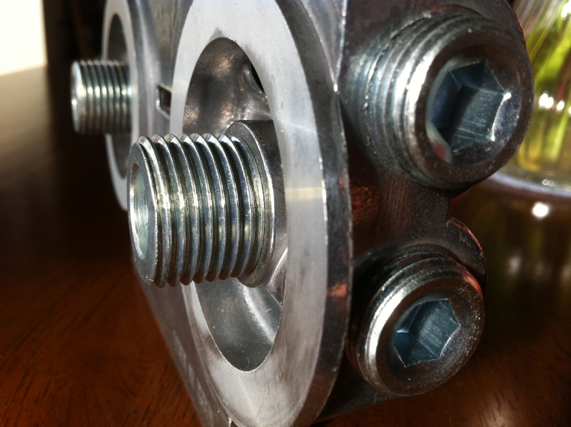

Here you can see the three mounting spots to hold the remote filter:
Mounting triangle
Mounting triangle

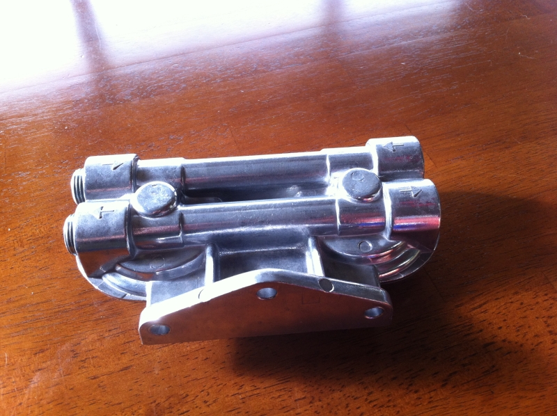

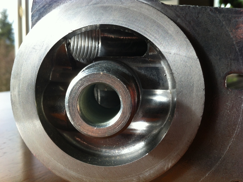

The working bits:
The working end
The working end
Closeup:
A closeup
A closeup
Side and Plugs:
Side and included plugs

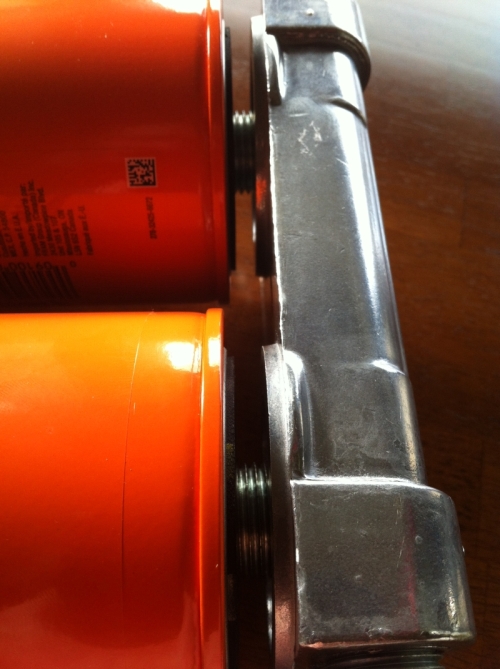

Unfortunately, the threads don't match!!!
Non matching threads?!?!?
Mr. Flibble
Posts: 1397
Re: 26mm Sandwich Adapter is here - along with other bits.
Post by Mr. Flibble »
If anyone can offer me any advice as to why the filters don't match the threads I would really appreciate the help.
The specs on those filters say "1-16", which is exactly what the remote filter says! I am guessing that the actual threads don't match - but I can't figure out why if they have the same size rating from everything I can see.
I will also add, that while the Jackmaster part looks much less shiny than the remote dual filter shown here, it is better made from a machining perspective.
The Jackmaster has some scratches and is not brilliantly shiny - but it has no sharp edges and is machined properly where it counts. This remote filter has been flaking off multiple sharp bits of aluminum from sections where it was drilled and tapped. I am going to have to spend some time filing down many parts of the remote filter mount.
The Jackmaster is otherwise ready to go.
Now I need to figure out how to get some filters attached though. Otherwise I can't use this thing at all. :-( :-( :-(

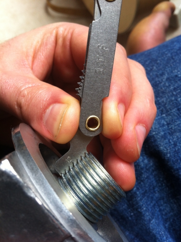

So I got myself a set of thread measuring tools. Looks like the double oil filter is 1"-12 thread, not 1"-16 thread. Which would explain why my filters don't fit!
I will be contacting Perma Cool about the threaded nipples being the wrong size.

Wow, so I contacted Perma-Cool about the mis-sized dual filter and they were incredibly responsive!
Seems that they had a small batch that had 1-12 nipples instead of the 1-16, so they got out the door wrong. They apologized profusely and quick shipped me a entire replacement piece! Not just the mis-sized nipples, but an entire new dual filter setup with the proper sized nipples!

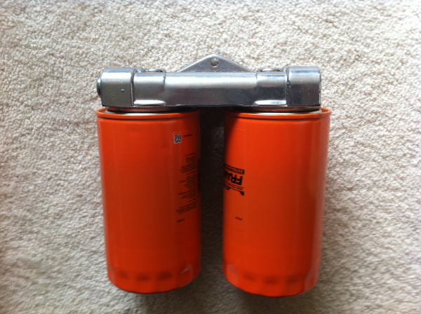

New adapter arrived via UPS!
Victory is mine!
So, if anyone out there wants to buy a dual remote filter with 1"-12 threaded nipples on it, let me know!

psilosin wrote:So what is the design of the dual filter? Are both full flow...and if so does 1/2 the incoming volume go to filter1 the rest to filter2, or does all go to filter1 first and then all to filter2 after?
They are both full flow. Half goes into one, half into the other and then back into the engine. It is possible with this sort of setup to install a bypass filter like a Amsoil one that restricts the flow a bit more, thus more of the flow would go through the other filter. But in this case, this is a $12 setup that increases the oil volume - and thus the cooling. My bypass filter will come out of the sandwich portion of the Jackmaster filter and go to my Frantz. I thought about using a centrifuge, but I already own the frantz, so that makes sense to use it.
If you look at the pictures of the dual filter closely, you will see some arrows on top. Those show the direction of the oil. One in, one out. The reason you can move the plugs around is that you may want the pipes to come in and out on one side, or go "straight through" for ease of mounting options. You could have two pipes in, and two pipes out, for even more volume I guess as well.
