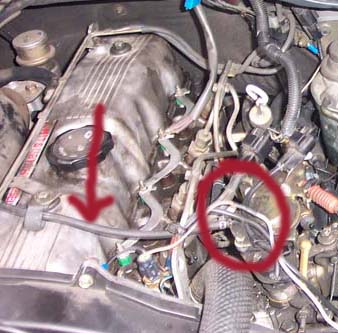

Just unplug the hose on the very top of the injection pump, put a small "T" in place with a pressure gauge of any kind (doesnt need to be a boost one, small fuel psi will work, just be sure the range is up to 20 or 30 psi max, otherwise it might not be as accurate), drive full throttle for about 10 seconds under load to make sure any lag in the gauge is gone and note the pressure. Adjust the wastegate, try again. It took 4 full turns on the turnbuckle (shorten the linkage) to go up 2 psi on mine. When you are done, remove the "T", plug the hose back in and you are back to normal.
Any small shop should have a simple pressure gauge but paying someone to do it might cost alot more than a $20 gauge, 2 x 10mm wrenches and 5 minutes of your life. Canadian TIre used to have that tool rental thing too and would have a gauge to let you use, not sure if they still do that.
Just dont try and adjust it without a gauge. If you go too high you will get lots of power but could destroy the motor. Everything I have read seems to suggest 15psi is fine for these motors. Do at your own risk.

Re: Boost Guage
Here is a pic of the signal tube to tap into for the gauge. Red arrow is the tube, circle is where it meets the injection pump. I can crawl under there tomorrow if it isnt raining and take a pic of the turbo. You access the adjustment from underneath by the RF tire, follow the exhaust up, find a big blob after the connector, that is the turbo, look for a rod with a long nut in the middle, that is the adjuster.
If it is really something that is wanted, I can make another step by step instruction thing for how to do it. I sometimes forget that not everyone is a mechanic and just assume I am making sense.
