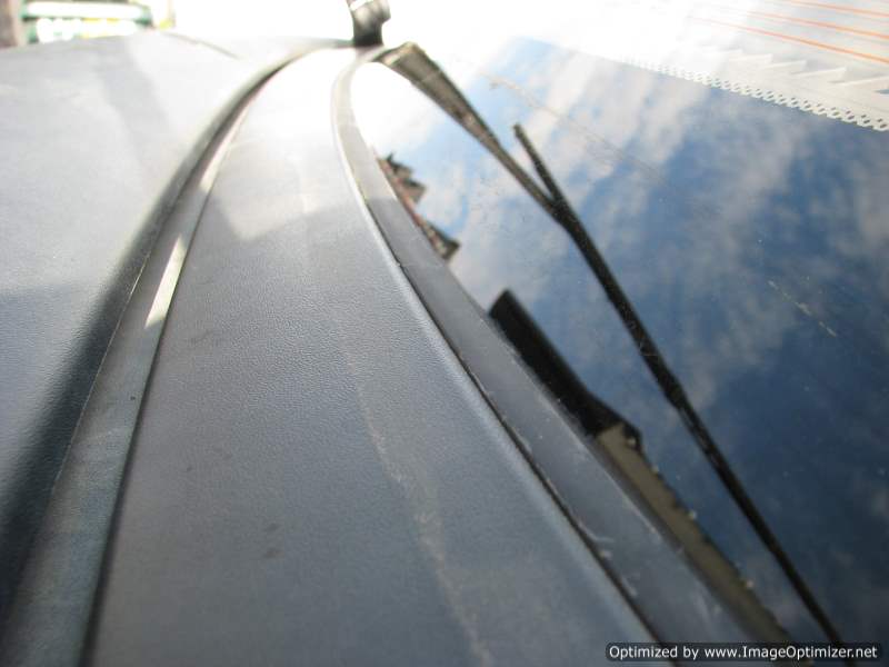

For those unsure of what we are talking about- here is a picture of mine and what the "formerly known as rubber" seal is doing. Right now it is a crusty hardened POS that constantly blows up and whaps off my windshield on a windy day.
I will post pictures when I get the new rubber to put on. I also had to buy some new clips that hold the tray down as the one on the far passenger side is missing. Unfortunately they come in bags of 8 so if any one needs on let me know. It looks like it is going to be a party trying to get at the missing clip- can't wait.

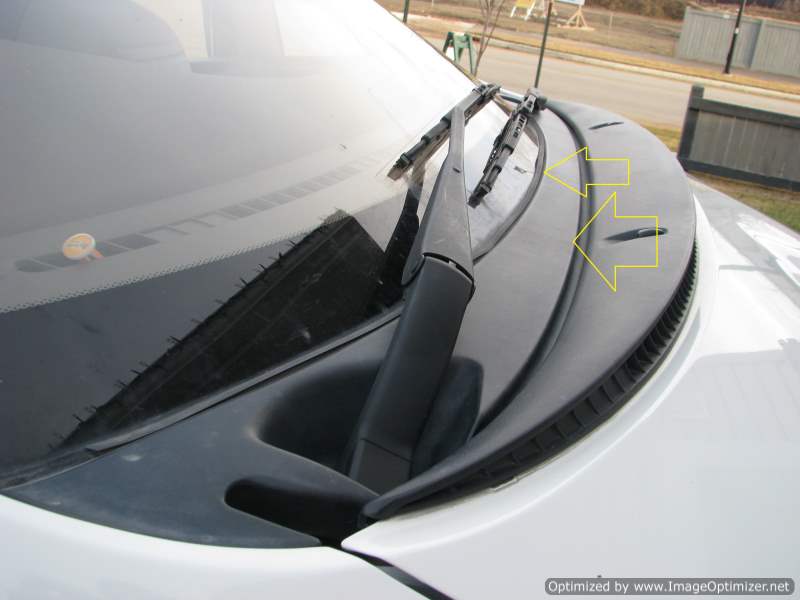

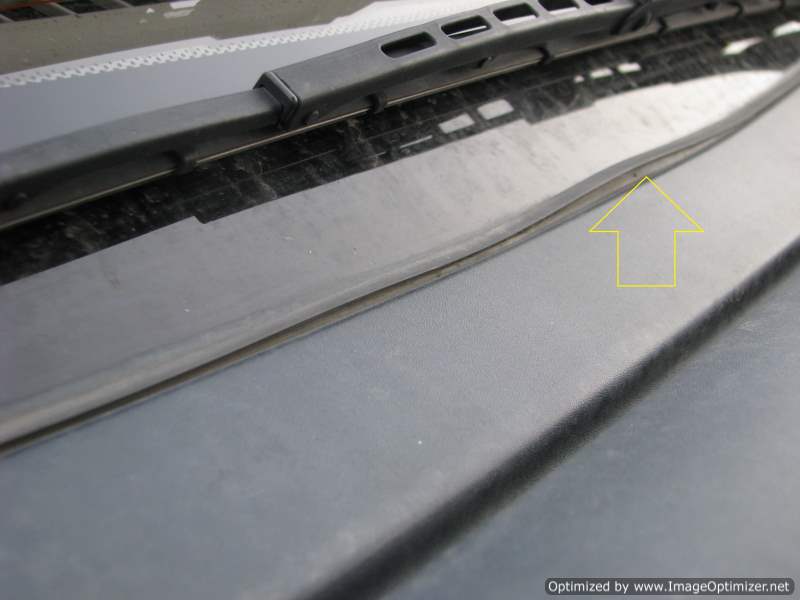

Driving home yesterday the old POS decided to blow up and wrap around the wipers. This rerminded me that I bought a replacement from RMI. Well, not an exact replacement, but now that I have installed it looks like it might work pretty damn good. It is for fender flairs on Landcruisers, but it is the same profile and style, but way better as it is actually bendable and not petrified. It also has an adhesive backing which may or may not help, but it is definitely better than the original.I also had to change one of the white clips that hold the little plastic tray down at the bottom of the windshield. Here are the pics:

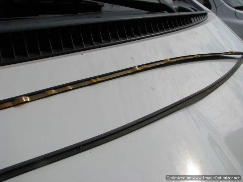

Here is a comparison of the old and new profiles:

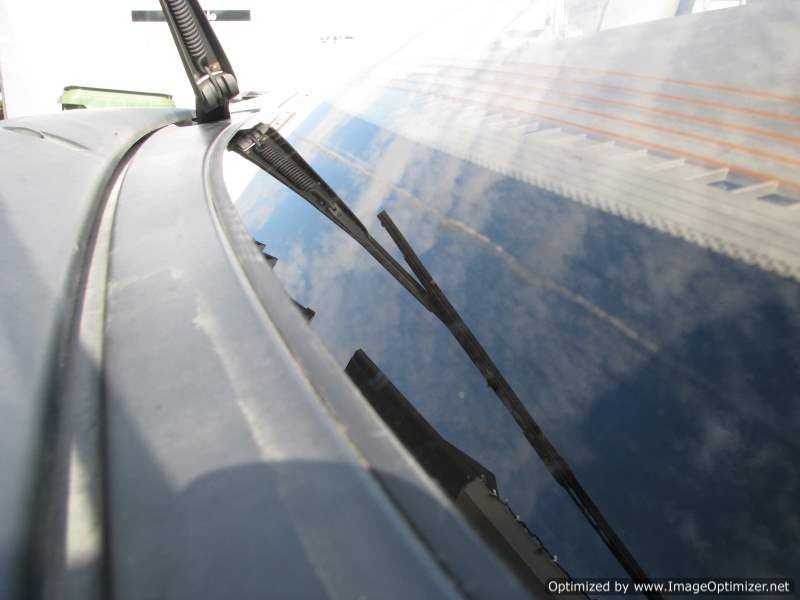

And here is the finished product. Looks like it was made for it.
The rubber was actually very inexpensive and I have to give a big shout out to Rocky Mountain Imports because they suggested this product. The only alternative is to order the whole plastic tray in order to get the new seal (I think it would have come to a 2-$300 bill. No thanks). I will keep you posted on how durable it is. Tah dah!
