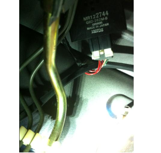

Re: Auto locks... working?
Thanks Jay,
I haven't had a chance to get underneath... What does it look like?
- TardisDeli
- Posts: 1425
- Location: Burnaby
Here is a picture of the door lock relay
- door-lock-relay.JPG (23.51 KiB) Viewed 9233 times
Christine
