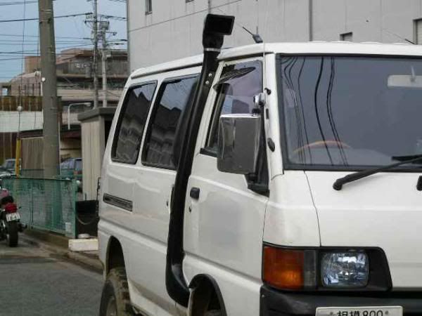

Found this pic with a snorkel fitted. I see, that's how it's done.

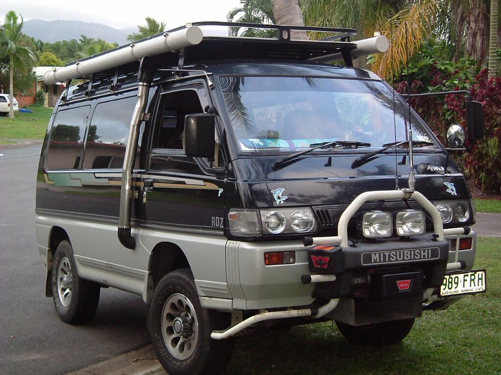

For about $400 CDN plus shipping you can get one from down under.
Of course you could probably build your own with $30 worth of PVC tubing
This one looks like it be a less of a brush snag
I guess if you get a snorkel you have to take care of the back end too

Thanks! Cool pics! Wonder if the $400.00 one is actually from ARB Safari? The middle pic of a white van has ARB top to bottom. Actually, my Samurai (will be gone soon, planning to import a Jimny) has a snorkel as well. I used ABS plastic pipes and a Safari snorkel head (about $100.00). Just have to VERY CAREFUL when boring the hole on the fender (as there is no return if one makes a mistake). But I can also tell you that snorkel sucks water droplets in on highway badly. One solution is to turn the head around, but for westcoast winter, there is still not perfect. Don't install a snorkel if just for the look.

not necessarily, the intake is a whole lot more crucial than the exhaust as the exhaust has pressurized gas coming out of it, it will usually keep the water out as long as you don't stop (and stopping mid stream isn't advised anyway!)I guess if you get a snorkel you have to take care of the back end too

It is identical to the one on the white van shown above - it is made from ABS and is manufactured by a company called VTTR.

I just noticed that the white van pictured above is a RHD with a right-side sliding door. Must be a rarity. Wonder if it has a left-side door too?

I've wanted to pop my exhaust out that side too, and go straight up behind a snorkel. I think that would be really cool. It would need some sort of protection from people touching hot things, That would add to it.
