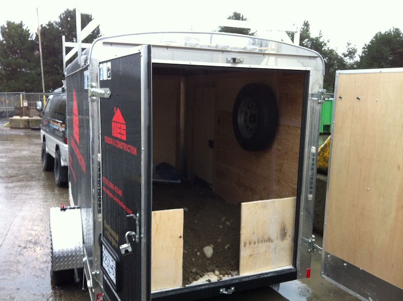

Well, I just went through a bit of an ordeal pulling my trailer. I'm bad at estimating the weight of soil and a guy on one of my construction sites said "I take soil with me all the time, as long as you don't take more than this [drew a line in a pile of soil] you will be under 2000lbs" 2000lbs is the limit to what my trailers axel can handle on top of the weight of the trailer. As it happened, I took the soil to the dump and it weighed out at over 4100lbs. This put the total weight I was towing with an L300 at around 5400lbs. On top of that, the E&H hitch is only rated for 4000lbs. Needless to say, it was a nerve racking trip and starting on a hill created a lot of vibration and was very slow. That being said, the Delica took it all in stride and I made it from Langley to Ladner in part thanks to the trailer brakes which were absolutely necessary.
I'm thankful to have made it safely, would not recommend it, but if you're thinking of towing a lot of weight with your L300 I can say that as long as you keep the weight within the ratings of your hitch and your axel you should be fine. My pyro was extremely useful and luckily was reading no higher than 1100 degrees at any point during the trip (I couldn't go faster than 80kph on the freeway though).

"How heavy is too heavy?" - I would never tow more than 9.36 tonnes. It's just simply too much.
Okay, I jest. But seriously, this has been talked about on this forum for at least 6 years now, and the consensus has been that unless you live on the Prairies, anything more than about a tonne is just too much for these little vans.
Good to read you got home safely.
NOTE: the dirt dug out of the hole for a building weighs more than the building itself. Dirt is deceptively heavy.

I once put two yards of topsoil in my utility trailer, behind my L300(about 3 tonnes) and would never do it again. I didn't have trailer brakes like you do, which was my main source of butt clenching. But, although the van could handle the weight, the poor little 85 hp engine sure struggled. I also worried about the transmission and everything else down the line. Now, I would never go more than 1 yard (about 1.5 tonnes)
I think the pyro might be giving you a false sense of security. I have to echo mararmeisto - you should be glad you got home safely. If you plan to do this with any regularity, you need a different vehicle. I can't believe that you thought it was a good idea to take all that weight on the freeway at 80km/hr. Yikes!
Ok, end of lecture, I suspect you learned a lesson and will just do two trips next time.
Re: How heavy is too heavy?...towing a trailer
I wasn't being paid to do two trips but would refuse the job in the future. I made a good profit on the ordeal but it wouldn't pay for repairs to the axel or hitch or covered my life had something gone awry. 80kph on the freeway was actually the safest I felt all trip and if it started to get squirrelly I just tapped the trailer brakes.
