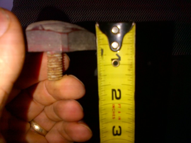

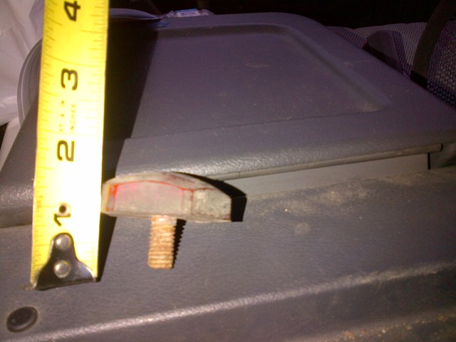

On the l300 and l400, the rubber bump stop for the upper control arm, can be replaced by a low profile polyurethane bushing, available from most of the aftermarket suppliers of shock bushings and suspension parts. I don't have any part numbers, I usually just look through there catalogs till I find it. Essentially it is about an inch shorter than the stock bump stop. With this installed, when you crank up the torsion bars, the front can be raised about 2" over stock, and still maintain ride quality, and avoid a cracked upper control arm, which tends to happen over time with ball joint spacers. This lower profile bushing does give you longer travel in the front, and you may have to reroute or lengthen your brake hoses and put longer travel shocks. On some though, everything is long enough. I think there should be the same bump stop on the Pajero's, but can't say for sure. I have a used low profile bump stop somewhere around here, If I can find it, I'll post a picture.
Jason

@ Jason -- Thanks I'll take a look for that front bushing you're talking about. I'd like to do this as painlessly and safely as possible.

by Manitoba deli
Here is what the low profile bump stop looks like. Threaded part on this one is 3/8" coarse thread.
