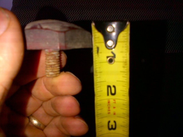

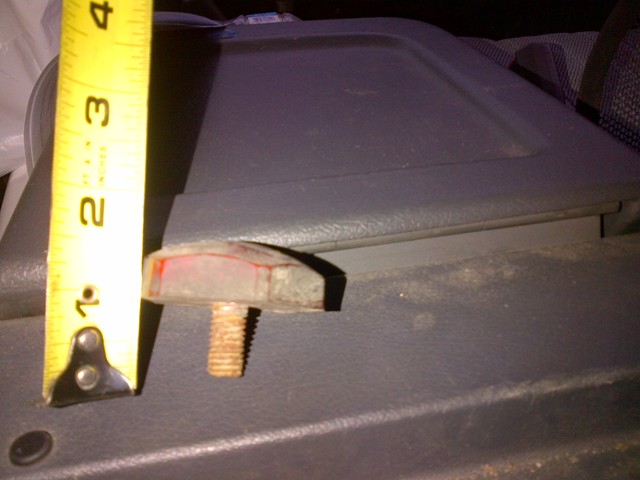

Here is what the low profile bump stop looks like. Threaded part on this one is 3/8" coarse thread.
