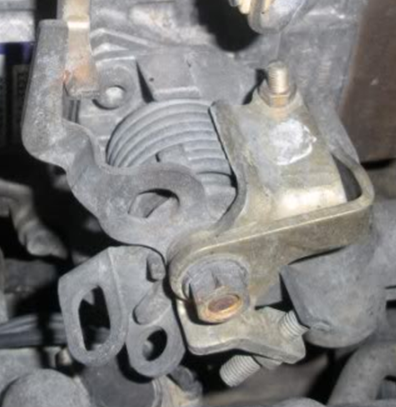

Can anyone shine light one which is which? I have been told the 8m on top of the flap is the cold (fast idle) adjust, if this is the case what is the one on the lower pat of the picture with the 10m jam nut on it? i attached a picture... hope it works

What engine are you referring to? Are you talking about the idle? Have you looked at the shop manual in the L400 Dedicated Category Forum?

4m40 yah I have a exploded diagram but it does not explain or state what is what I have no fast idle and am looking for adjustment I have adjusted the 8m one and also have been told the 10m one is the fast idle... So needles to say I'm confused and would like to know what is what... If neither adjustment works it look like its the wax thermostat in the pump

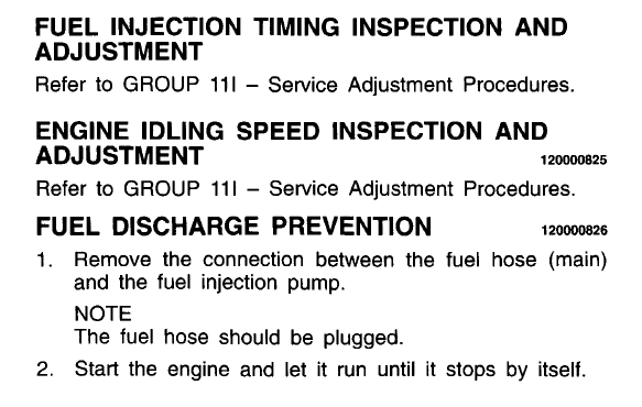

i have have gone through that many times and cant seem to find an answer it says that adjustment are under section 11I i believe but the section is not there.
11I covers idle set and adjustment

Yah I have read that thread before but have been told that the other one is the cold start.... Even if its not I would love to know what it adjusts? Any ideas? It seems to be linked to the throttle and high idle too

Section 11 is the engine, 4M40 being 11M, 11I is for the 4D5 Astron engines. Both of these are there (along with 11D, the 4G6 motor). I believe they both use the same injection pumps, not 100% on that.403delica wrote:i have have gone through that many times and cant seem to find an answer it says that adjustment are under section 11I i believe but the section is not there.
I was glancing at 13F (Fuel Supply & Engine Control). It refers to accelerator cable inspection and adjustment. Could this help?

i attached a pic of what i mean by 11I... its under the diesel fuel heading and is exactly what i need, its talking about idle etc. but i cant seem to find it

so the 8m screw at the top controls cold start advance and retard... the 10m ( bitch to get at ) is the fast idle set as far as i can understand... i think i have it now?

Well I have adjusted all screws and have no result... Still no fast idle. Vehicle starts fine, runs amazing well the glow plugs are on. Once they kick out its all down hill from there unless I use my foot to keep idle high
Any other ideas my fellow delica lovers?
