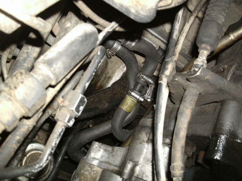

Here is a picture of the upper hose attching with a T to the lower heater outlet hose coming from the head.  The pic is from underneath forward of the front fuel tank. With your hood open, look down behind the IP, you will see the two hoses exiting the head..either will do but the lower is easier to T into with clamps.

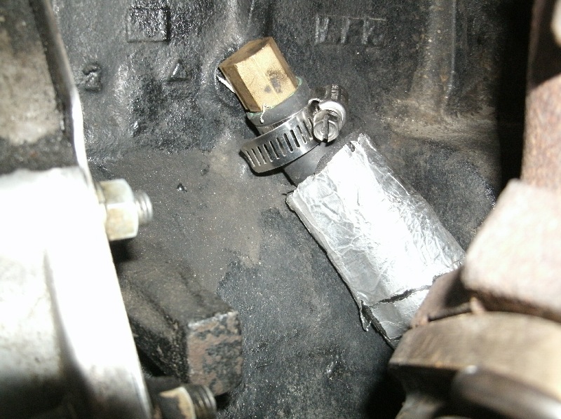

This is the block drain plug.  I simply used a 1/4 NPT elbow with a section of pipe towards the coolant heater.  The coolant hose is wrapped in hose insulation and foil tape from Home Depot.

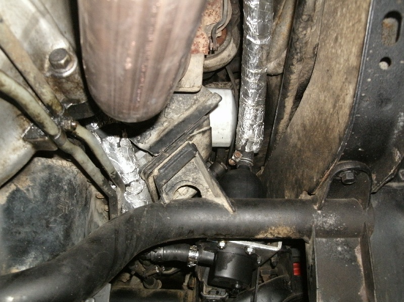

Hard to see, but this is looking forward from behind the trans towards the driver.  Looks tight, and indeed it is, but removal of the oil filter is possible without undoing the heater bracket.  Looks close to the manifold but has plenty of clearance...not even warm from driving.
