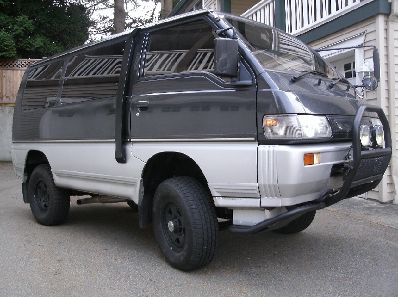

Well here it, is my "ghetto" snorkel....created out of necessity, but mostly absolute boredom from having to lessen my excercise from having knee surgery.
I made one for a few reasons, first I had to relocate my air intake from the wheel well as I was planning on routing my intercooler tubing in the same area.( I have since changed my mind, but do have the intercooler for those needing one cheap..$75 with louver cover) Second, I had body damage on my B pillar directly in the location where a snorkel would mount. Thirdly, cooler air would only help keep my intake charge down. I have no direct use for forging streams and the like, and my understanding of turbo charge systems tells me there is no benefit to "ramming" pressurized air into the intake, as it is regulated by the turbo regardless...

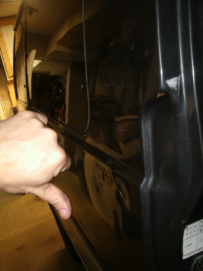

- Thought this was a good pic showing the 2.25" hole, I also drilled a small access hole above it from the inside for the one mounting screw to "pull" the snorkel into the body.

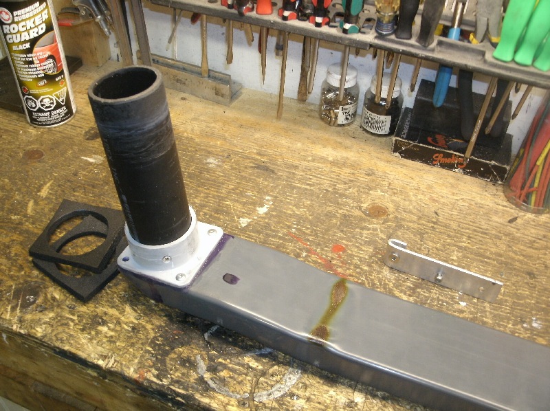

- Molded the PVC with a heat gun, then sanded'er down and painted it with Rockguard
- GEDC0036.JPG (201.85 KiB) Viewed 7051 times

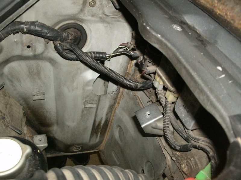

- Clean and easy routing. Keep it simple moto in effect here. Note the access hole for the one mounting screw above the intake hose through the body.
- GEDC0052.JPG (161.56 KiB) Viewed 7051 times

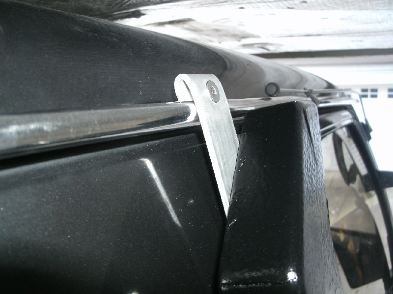

- Made a clamp out of extruded aluminum and a stainless bolt, made for a very secure mount, and didn't require more drilling!!
- GEDC0061.JPG (121.85 KiB) Viewed 7051 times

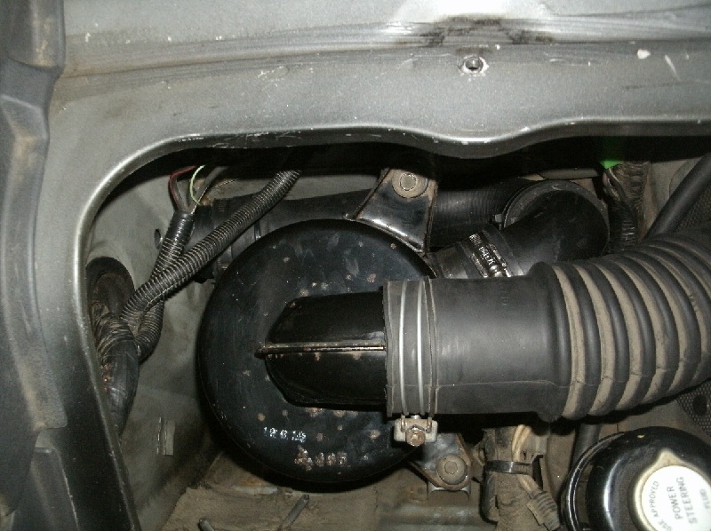

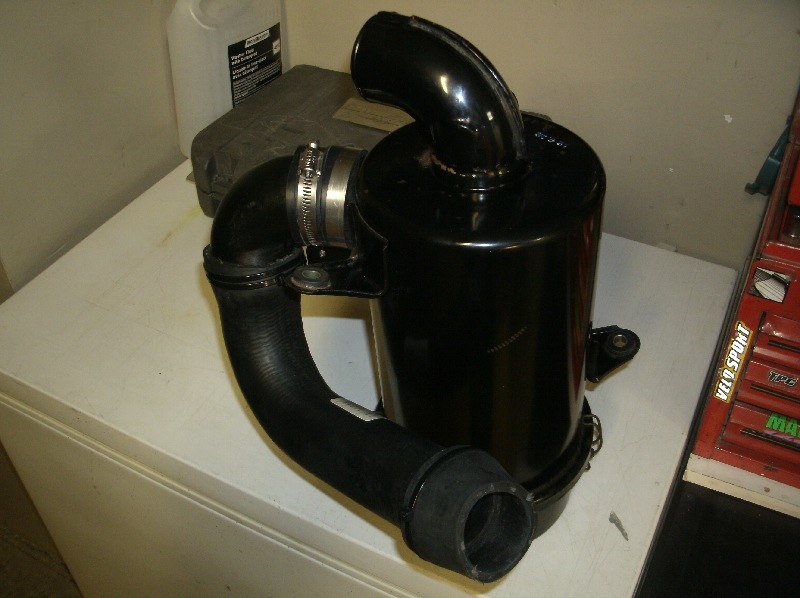

- I felt it to be too time consuming/unnecessary to modify the box, so I copied the UK guys and was able to route it cleanly. The rubber end coupler looks tapered, but is will expand to join the 2" ID ABS on the snorkel.
- GEDC0041.JPG (110.32 KiB) Viewed 7051 times
- Really tight to the body, with no additional wind drag was a bonus!
- GEDC0063.JPG (184.96 KiB) Viewed 7054 times
