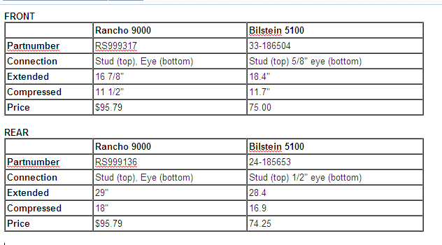

This is the info I've compiled so far. The Rancho PN were read off the van and specs from GoRancho. The Bilstein info was provided by eShocks based on the rancho info. If you are able to validate, that would be amazing.
Sorry about the image, a spreadsheet is attached.
J
J

those extended and collapsed measurements between the two brands are a bit off, make sure they are off in the right direction. you dont want to bottom out during extension and especially compression. since you have a lift, you may have to reconfirm by doing a static measurement of the vehicle suspension between full extension and compression to bumpstop.

Thanks guys -
Yes, the Eshocks guy did say that "these parts were the closest I could find".
I will double check the specs of both and learn more about static compression tests.

Just so the world knows. I lashed out and bought the shocks. I can tell you that in stock trim, these shocks fit but bottom out big time on compression. They arent even close. Fronts appear way too long and under damped. What I dont get is how those rancho measurements above can be from a Delica? No way they would work without major lift and bump stop mods. Rears appear 100mm too long for stock bump stop height.
