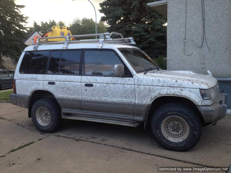

Hi everyone,
94 LWB Paj with the 2.8 5 speed. Starts fine, but sputters for the first 30 seconds or so. I'm not sure if the cold will make it worse as I have only had it for two months. Even on a warm summer morning it would sputter for 30 seconds. What does everyone think? Fuel filter? Injectors? Glowplugs? The PO said the injectors were replaced around 30000km ago, the rig has 140000km on it.
Also, the turbo seems to tug and sputter on heavy load. No leaky sounds or purging, but an intermittent tug on heavy load during acceleration. Once I hit cruising speeds whether it be highway or 70 km for the city, the truck runs fine.
Any and all help would be great. Hoping to get "The Enterprise" nice and healthy before the -35 hits this winter.
