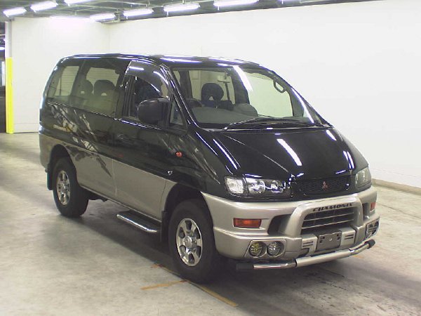

The changes are mostly aesthetic. Gassers are going for about 1/2 the price of diesels at auction. The importable series 2's in diesel are going for a premium at the moment - but the importable series 2 gassers are still going for a steal at times. I like the chamonix
If you haven't stumbled on this thread:
http://www.delica.ca/forum/diesel-versu ... 64-15.html
This one was a 4b - only 66000 kms, sold for 90 000Y (like $1200) There are many such examples.

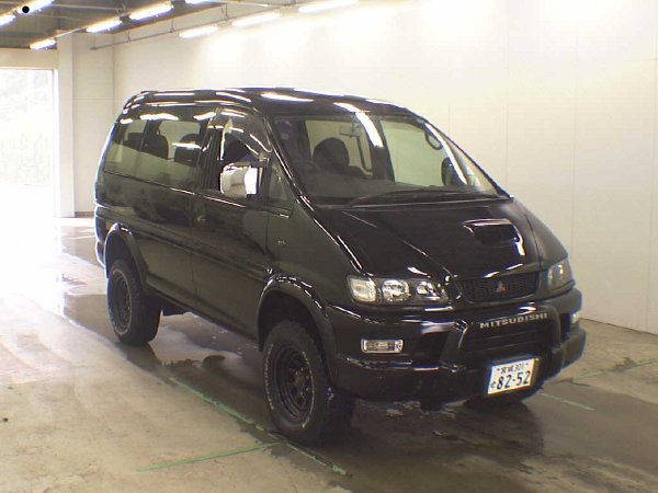

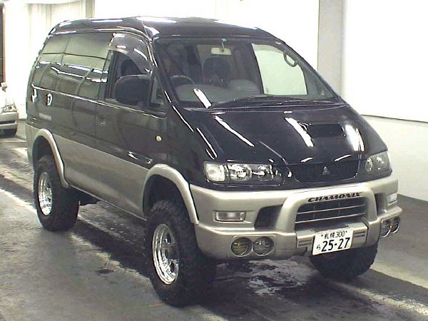

I agree, but nothing like a nice pair of boots to improve things. The bush bars were were dumped due to changing regulations. Pedestrian safety. Even 1998 L300s lost their bush bars.
- blackchamz.jpg (45.46 KiB) Viewed 5608 times
- delica.jpg (61.02 KiB) Viewed 5608 times
Re: Back from the (mostly) dead. Avec la questions.
Take one of those last 2 and put a mean bullbar on there and I'd bet that would look awesome!
