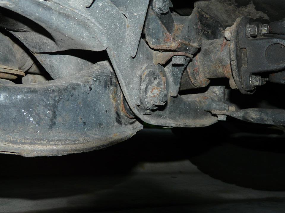

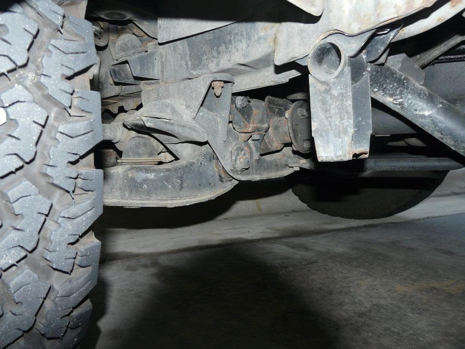

Here are the best pictures I could take... the centre of the photo is the bushing in question. If this is indeed the lower control arm bushing what do I need to ask for at the parts store? If it is the lower I have no idea what kind of shape the upper is in but I definitely won't be sending away for a completely new control arm to be sent across the country.

Re: More, shall we say, inconveniances while travelling
Professional Mechanics?
Torsion bars = 17mm wrench and turning no big deal (do this yourself 15minutes)
-if it is the lower control arm bushings you should be fine as the extra force goes to the uppers
Tie rods if they are truely bad fix them....you do not want failure driving (I am not convinced they are bad)
-jack up a front wheel and pry on it does it have steering play before the tire on the ground moves? look for the play
Post up on overlander see if someone will help...
Just drive it (I have spent lees $400 on cars changed the oil and driven 100,000km without repair....you will be fine)
just drive it like it is worse case is you wear down two tires....second mechanic found no tie rod prblem (these mechanics do not seem to be interested in working on your truck)....
Just get your passenger to turn the steering wheel back and forth from 10 and 2 o clock position quickly. Then you climb under the vehicle and feel all the tie rod ends anything that has a lot of wiggle or movement is done a little is fine you will know the difference.
