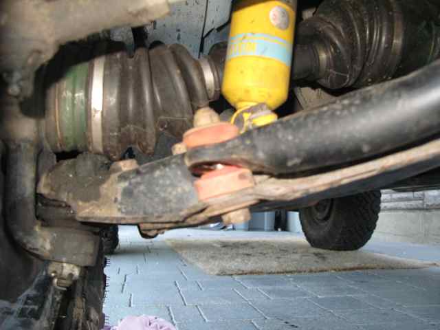

One I have had for quite awhile-- I just can't seem to tighten up the bolt on the sway bar link enough so that the end of the bar sits properly between the bushings. The angle seems too extreme, and has been since I did a lift on my van a few years ago. I figure this is the source of a clunking sound that I have had for quite awhile when the weight shifts from side to side around corners. I think it is the bar slipping up and down on the bolt.

- IMG_2896.jpg (27.93 KiB) Viewed 9826 times
- IMG_2899.jpg (26.22 KiB) Viewed 9826 times

You could used washers to shim up the lower bushing. As for The brake line stop driving your delica. Lordco,Napa should bed able to cross over the part number for a montero.

for the bushings, they are thin to begin with. The alternative (which I've done) is to put in a taller/fatter bushing on the bottom as that is where the largest gap is. From what it looks like you should be able to tighten down that nut a lot more. The bolt/nut look in poor shape. Measure the length, add on one inch and take that measurement and pickup a pair for grade 8 bolts with national fine thread and two stover nuts to match. This will make reinstallation much easier.

Judging from the angle of your sway bar to the mount and the difference I have to ask an obvious question..... Has your sway bar ever been fully removed? And possibly installed the wrong way (upside down)? I doubt it and I don't know Delicas but I had to ask. And yes I second that. There should be retaining washers.

That does not look correct!Is it possible the nut has bottomed out...You might need a shorter bolt or a bolt with longer threads.
Actually come to think of it your lift Mod probably caused it... Can you shim out the upper attatch point to drop sway bar down a wee bit?

I think that is what caused it. Tightening it doesn't seem to help, but I will be trying some/all of the suggestions in this thread.dennis_lambert wrote:That does not look correct!Is it possible the nut has bottomed out...You might need a shorter bolt or a bolt with longer threads.
