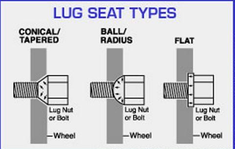

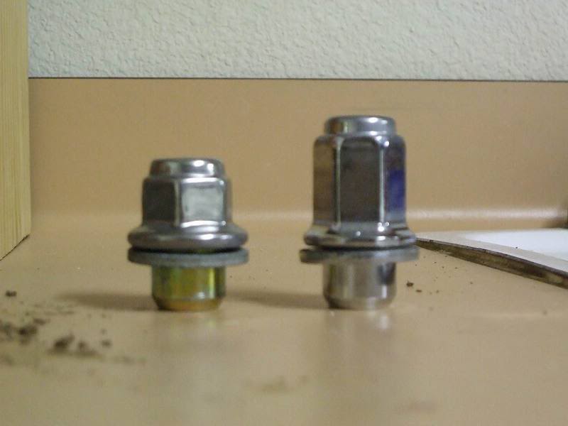

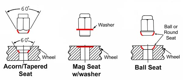

If the wheel has a tapered lug, use acorn/tapered seat style lug nuts (Mitsubishi common)
If the wheel has a flat lug, use flat/mag seat style lug nuts.(Toyota common) *pictures below

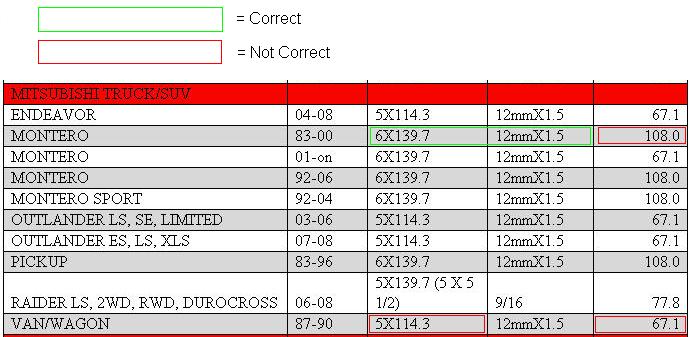

FalcoColumbarius wrote:In the "Useful Links for Vehicle Part Identification Purposes" thread, located in the Delica FAQ Section there is a link to a "Wheel Rim & Stud Pattern Guide", courtesy of Tonydca. Perhaps that will help.
By posting this, you are inferring that a member enquiring about wheels can use that chart to purchase wheels for an L300 which is incorrect.FalcoColumbarius wrote:Check out "Useful Links" in "Delica FAQ". There is a wheel pattern guide that was provided by Tonydca. Very useful.
The correct information below has been posted (above) hand over fist in the past few years on this forum yet is not stickied nor in the FAQ section.
Screenshot taken from the FAQ link:
http://www.delica.ca/forum/useful-links ... -9208.html
http://adaptitusa.com/referencebook.htm
- Wheel Rim & Stud Pattern Guide.jpg (59.2 KiB) Viewed 7572 times

There can be grave/fatal consequences if using a tapered acorn style (Mitsu) lug nut on a flat hub centric style (Toyo) wheel or vice versa.
