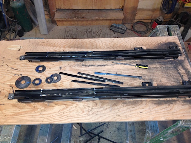

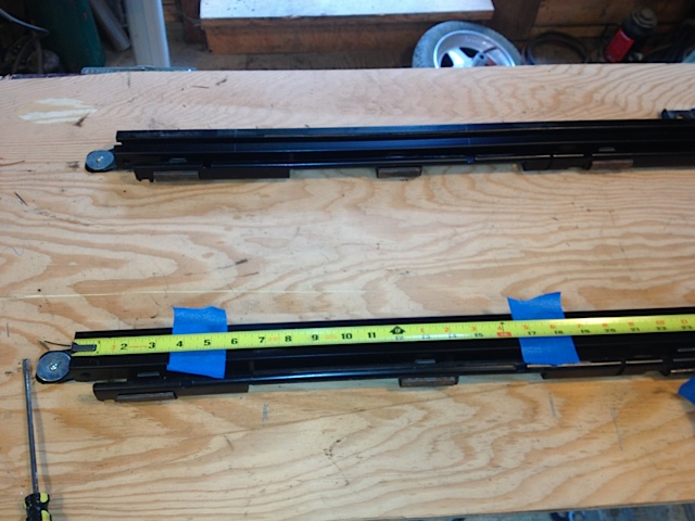

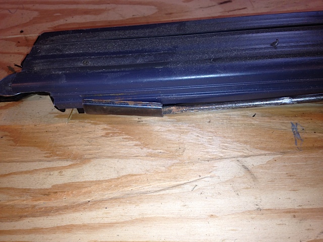

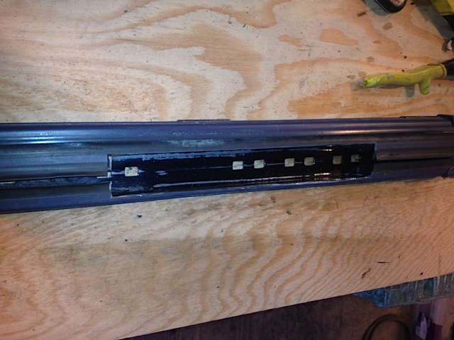

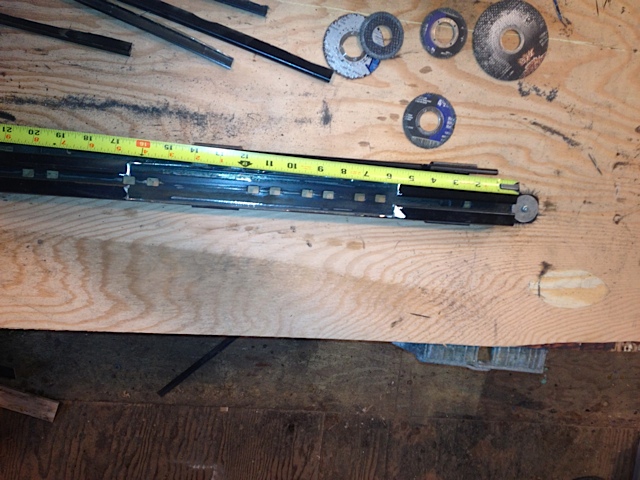

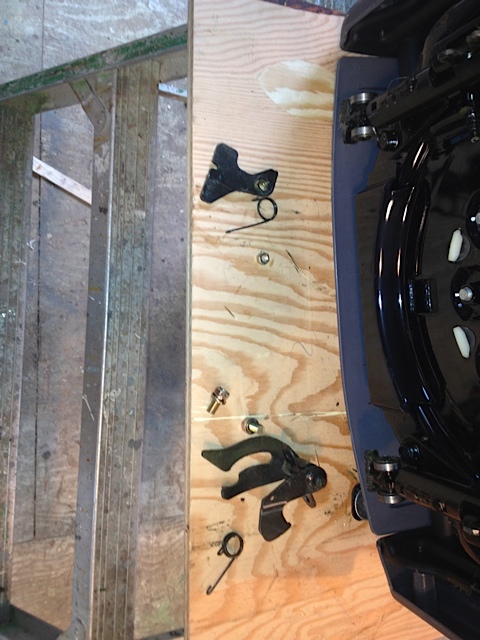

From an idea of RichD

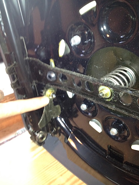

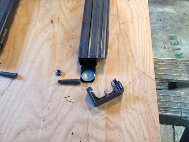

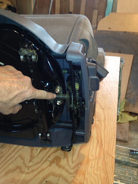

Now I can lift the seats in and out with no tools and leave the tracks in place. Also removed two brackets that prevent the seats from swivelling in the forward position and the seat from moving all the way forward with the seat in the down position. These are two "safety features" that I don't need.

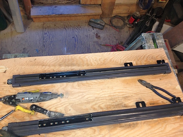

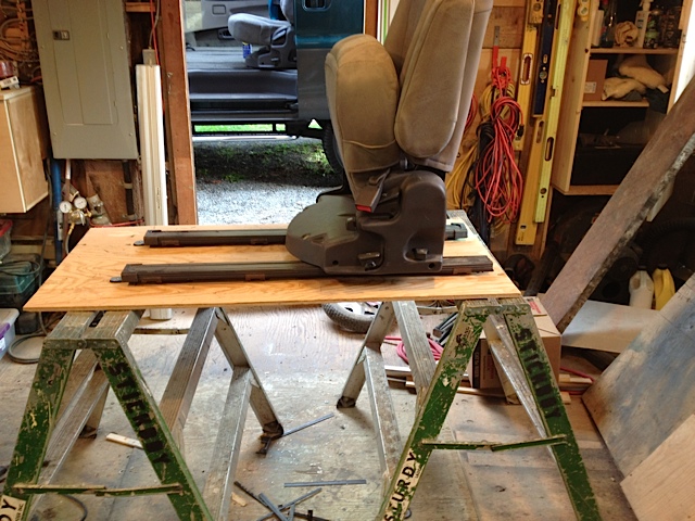

I started by skrewing the seats to a piece of plywood so I could test without crawling in the van and it made it easier to do the cutting and assembly.

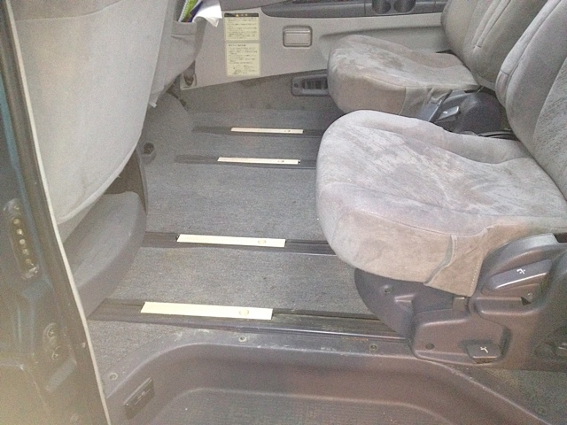

The seats just drop in now and slide as they always did and there are blocks in the tracks that prevent passengers from self ejecting underway.
With the blocks out the seats slide all the way forward for room for hauling or making room for chillin
This is by far the handiest mod I've done. I probably take the seats in and out for work and camping 6 or more times a year.
pics on the way.
pics on the way.

Re: L400 captains chair removal mod
pics
- IMG_0432.jpg (134.39 KiB) Viewed 10199 times
- IMG_0431.jpg (114.74 KiB) Viewed 10199 times
- IMG_0430.jpg (129.28 KiB) Viewed 10199 times
- IMG_0429.jpg (172.89 KiB) Viewed 10199 times

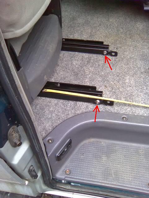

Not possible in the stock configuration unless you make a few mods because the channel rails sit flush with the floor carpeting and underlay.Mr. Flibble wrote:if you were to cut holes in the very back of the rails, would it be possible to remove the seats in a backwards pull fashion?
One of two ways.
1. cut out the carpet and underlay approx 10 inches in length by 2 inches width behind both sliders. Just enough so that the seat can be pulled out of the channel guide. You'll have to unbolt the retaining pin at the end (red arrows below)
2. raise the sliders above the carpet.
Option 1 would be ugly.
Option 2 is doable with solid flat bar to act as spacers in between the floor pan and the bottom of the channel rails but it would raise the full slider length above the carpet. Tripping, aesthetics are the two downsides.
If you look 1/2 way down the page, you can see the height of the stock slider compared to it raised when I did the swivel mod on the passenger side (I lifted it up on the front by 3/4")
http://www.delica.ca/forum/l400-swivell ... -7464.html
As for this thread mod, the legality of it is an unknown but I'm guessing it wouldn't sit well with the man. Then again, my first L300 came with a jump seat on the middle bench without a factory seatbelt. The mod is cool. Useful if re&re'ing the seats often.
