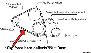

A correctly tensioned alternator belt will deflect 10mm when pushed with a force of 10kg (or 98N if we're being technical). If they continue to squeak when correctly tensioned you'll need to replace the belts. Don't overtighten them in an effort to stop the squeaking- the water pump bearing will fail. Trust me, I know.
To check tightness, find something that weighs 10kg (about 20lb) and lift it with your thumb- thats how much force you're going to put on one of the belts. From below, push one of the belts with your thumb with a force of 10kg*. The belt should deflect about 10mm/half an inch relative to the other belt.
