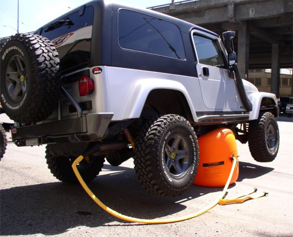

or get an x-jack
Re: Hi-lift vs Farm lift vs no lift?
I think I've found my answer...no lift!
How is an x-jack better than a bottle jack?
- xjack-2.jpg (55.29 KiB) Viewed 3715 times
- XJack_2.jpg (117.64 KiB) Viewed 3715 times
It looks easier but could it not damage certain components since its not on a jacking point? I think the idea of blocks and a bottle jack would do fine in this instance.
Pajerry, I think it's funny that you used drag and mpg's as a deterant. From that statement I would have thought you'd never seen my van.

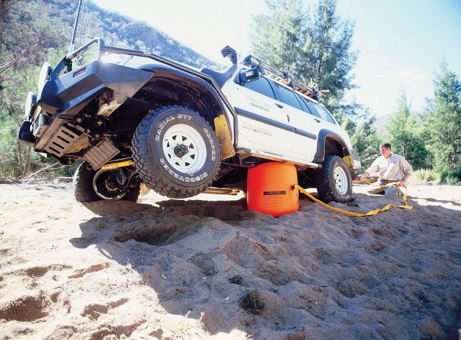

a bottle jack won't save you in the 2nd pic (sand/mud/soft ground) plus don't they only extend to 12-14 inches?
an x-jack can be used alone or in conjunction with another lifting/blocking aid on the trail. A bottle jack on the trail is almost useless unless the ground is solid/level underneath the axles. You can use wooden blocks but how many you use/carry on board can be a pain.
