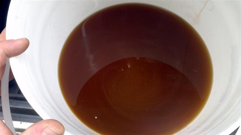

When we purchased it for a pretty good price I noticed the Pajero's
coolant was reddish. I honestly thought it was somewhat tired
heavy duty coolant,(its Red rather than day-glo green) but I was
so so wrong...
2012-03-29_11-58-12_149 (Medium).jpg (97.18 KiB) Viewed 2239 times
So I channeled the spiritual and contorsional energy of
a tiny handed Mitsubishi Tech/J Farsang small paw,
and got the very badly placed rad drain valve open...
got some yuck in a bucket

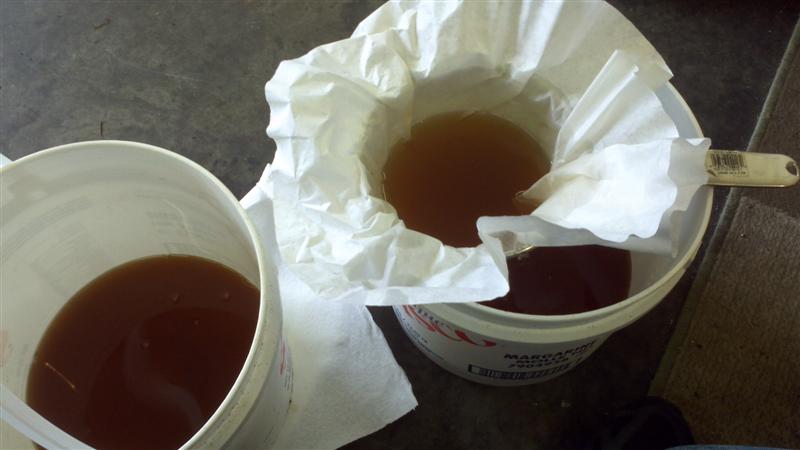

Then I got the idea to run the crap through a coffee filter for
a better idea of how much crap was actually in the fluid...
2012-03-29_12-36-37_979 (Medium).jpg (80.89 KiB) Viewed 2239 times
more pics of this to come,cant find all the pics right now.

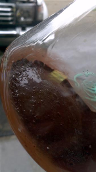

Also was completely horrified by the sediment in the overflow bottle,
there was a half inch of muddy crap that was a complete pain to get out. I used a hose,toothbrushes for the first attack and then a Dilute
batch of CLR ,seemed to really loosen up the crap. Did not melt the bottle like a was wary of..
Here is a pic of some settled crap ,this was after a couple of flushes with water too....
2012-03-29_16-17-15_878 (Medium).jpg (62.52 KiB) Viewed 2239 times
