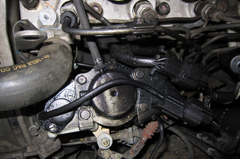

Hey guys,
Not sure exactly what this part does but noticed the metal has cracked and is leaking a bit of oil. Any ideas on what to do?
Thanks!
Thanks!

Re: Oil leak from tiny part
that is a vacuum (air) line for boost from the turbo
clean/wipe down the oil in the surrounding area and see if you're getting oil blown through
OK. Just checked and looks like I am. I wiped it down yesterday when doing an oil change and it's dirty again.
That's a pressure line coming from the turbo for the boost compensator on the top of the fuel pump.The boost compensator increase or decrease the amount of fuel injected into the engine in relation to the amount of boost provided by the turbocharger.
The leak is coming from the turbo,maybe your turbo is leaking a bit. Nothing really wrong with that if engine oil comsumption is normal.
Repair this and you will probably find that your van will have more power!
I was going to mention something about that actually. I know L300's aren't power beasts or anything but mine feels pretty pathetic much of the time. Basically if I hit a hill or even an incline on the highway my RPM's start to drop. Much of the time it feels like the van is trying to hang onto a gear for too long (most noticeably 4th ((auto trans)) ). Steeper parts of the Malahat leave me in the 50 to maybe 60kph range with no load and I get passed by everything. With 4 passengers I can be in the 40-50 kph range. Could this be part of the cause?
Oh yeah!
Repair the nipple on the boost compensator and you will see a difference.
Would a sort of epoxy work to seal that or does the part need to be replaced?
Maybe the best should be to replace the cover of the boost compensator or remove it and weld a new nipple on it.
Check for used parts from Delica dealers,Rising sun,Amazing auto,Maximum Overdrive or other.
