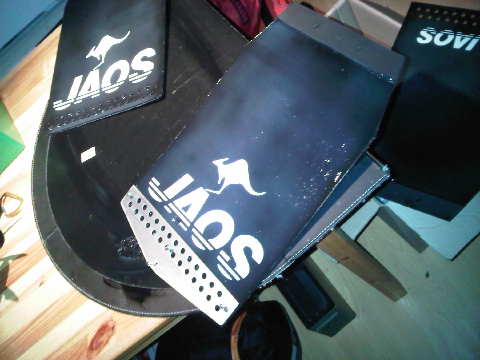

So as most of you JDM nuts know JAOS is a bad ass but highly over priced (and over rated) accessory company. I do however like the look of their "Rally Style Mud Flaps" but the price of $245.00 for a pair.. yes PAIR! is ludicrous. So .. me being me and having and Italian last name said to myself.. "I could make those for much cheaper" .... so I did. ***SKIP TO SECOND POST TO SEE START OF PHOTOS THEN BACK HERE TO CONTINUE :S ***

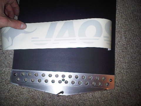

Went to army navy for stainless hardware.. Down rigger stuff works well stainless cable split swivels etc to anchor the ends of the flaps to the body so they don't swing forward and hit my tire.. just like them authentic fancy JAOS ones!
..............ebay
..............ebay

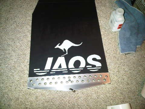

Ebay Decal time!
Ebay Decal time!
Decal is now on but doesn't want to stay stuck.. Vinyl decals don't stick to flexible rubber...duh.. solution?

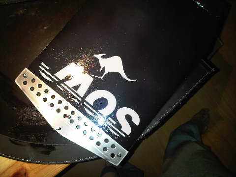

I then used clear silicone and used a straight edge to "silk screen" a thin protective layer over the decal to keep it new and protected..

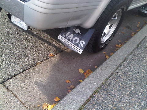

Finished
Finished

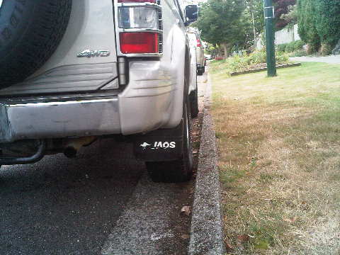

The result...
The result...

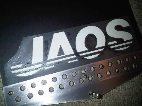

Back to front.. oops. This is the start of my project. I ran out of room on my first try.
Before... with a sticker :(
The goal.. so I bought some rubber flaps from Crappy Tire for $50 and got to work with scraps..

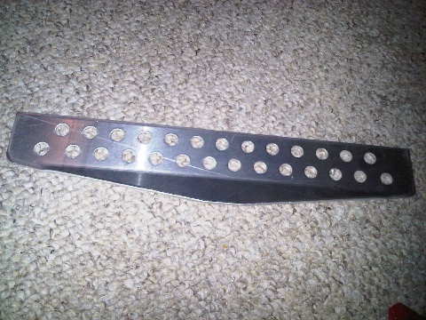

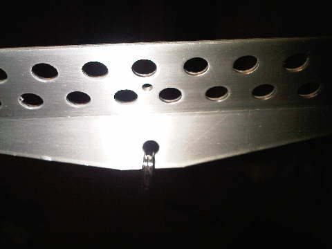

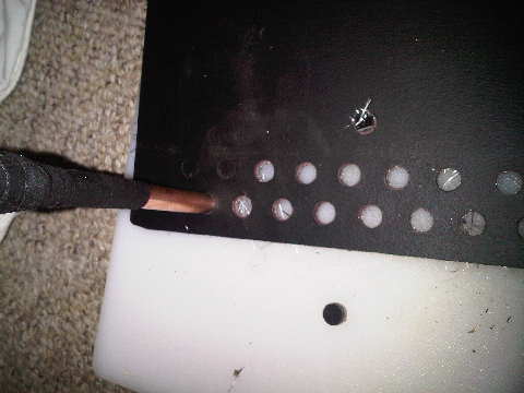

Made a hole punch out of 3/8ths copper by reaming the ID and sanding the OD to a point.. then 1 hour and 25 hand cramps later I had holes to match the fancy aluminum I had made up!

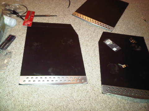

Thanks to a fabrication shop at work and access to copious amounts of scrap aluminum and stainless I was able to bang these out of 14ga aluminum, bend them, and use the punch to rittle them with holes (JAOS says they are for air to pass through to eliminate drag.. I say the are speed holes like homers)
Coming along.............
