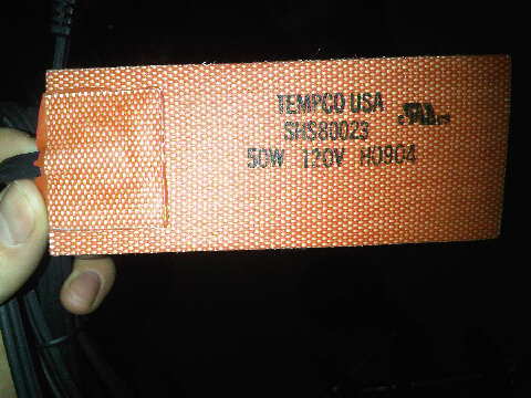

I wouldn't worry to much about it. Mine is like that as well. I usually click on the glow plugs 3 times and it helps it flash up quicker. But plugging it in is always a good idea and no one will think any less of you for doing that in 2 deg weather either, it cant hurt but not plugging it in can. You could also install an oil heater for real cold weather.. be kind to your engine by not trying to pump molasses through it.
- IMG00916-20110124-0827.jpg (26.51 KiB) Viewed 8536 times
i like cheese
