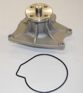

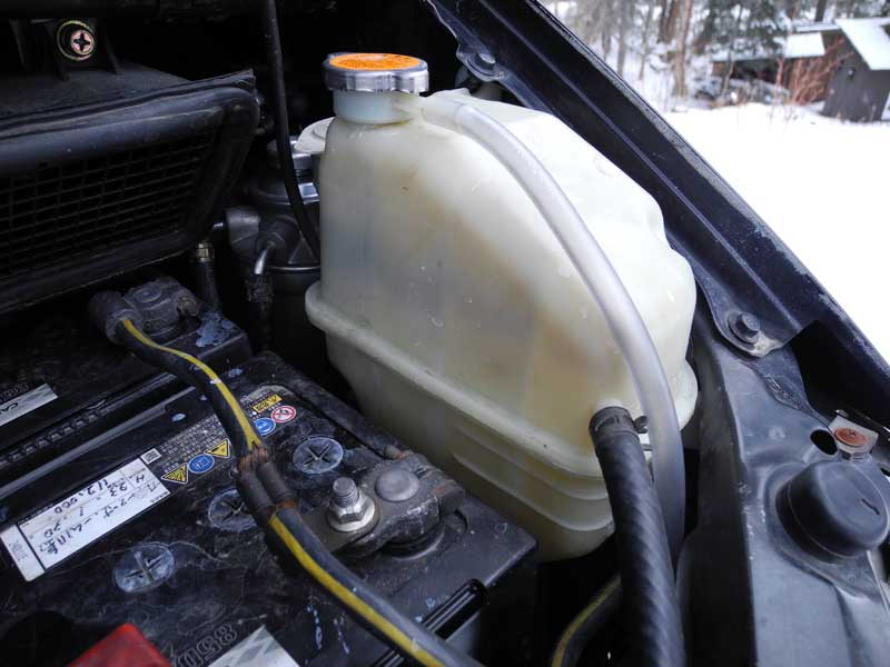

Can you take a picture of the expansion bottle and water pump please?

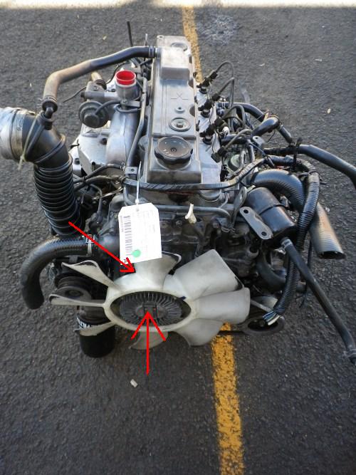

Sorry about my ignorance but where is the pump located?jfarsang wrote:not a good idea

look down the middle of the engine. the fan attaches to the water pump pulley. it's behind the fan.
- stk-3189_p1.jpg (63.99 KiB) Viewed 5010 times
- waterpump4m40.JPG (7.12 KiB) Viewed 5010 times

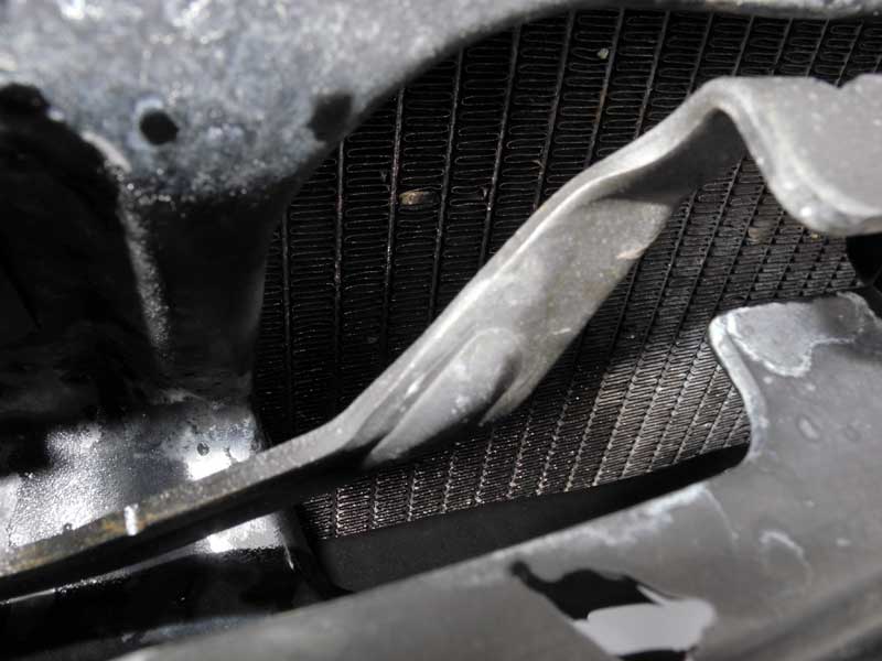

There is the pictures ,
I will do a leaking test when the snow stop
- I suspect this is the leak
- Hole-_Rad.jpg (45.96 KiB) Viewed 5001 times
- Water-Pump.jpg (135.29 KiB) Viewed 5001 times
- expansion bottle
- Expantion_Bottle.jpg (47.37 KiB) Viewed 5001 times

water pump and coolant expansion bottle appear to have been replaced so you can check that off.
If you pour water into the bottle, does water come out from the bottom? Two coolant hoses may be hard/not clamped.

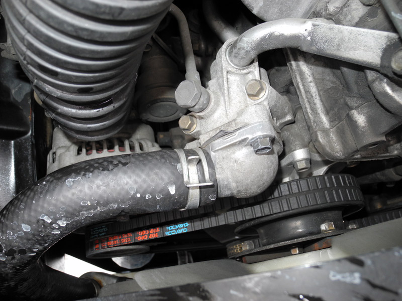

Looking at the pictures you posted your rad hoses look pretty old ~ could be a loose connexion or a small split in the hose? Also have you checked the rad cap? I would be inclined to grope over your upper and lower rad hoses when the engine is cold (and off) to see if you can find any soft spots or if it divulges the leak. If you have a split... in a pinch one could try a lot of duct tape, but I wouldn't bank on it. Do you have other means of mobility? Say to the Pemberton Greyhound depot?

Your radiator doesn't look good. In hindsight, it's a shame the dealer didn't replace it. If you trace the leak to the radiator, your cheapest/best option is to order a new radiator, have it shipped to you and install it.
