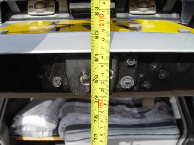

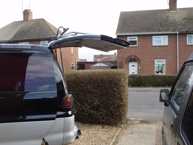

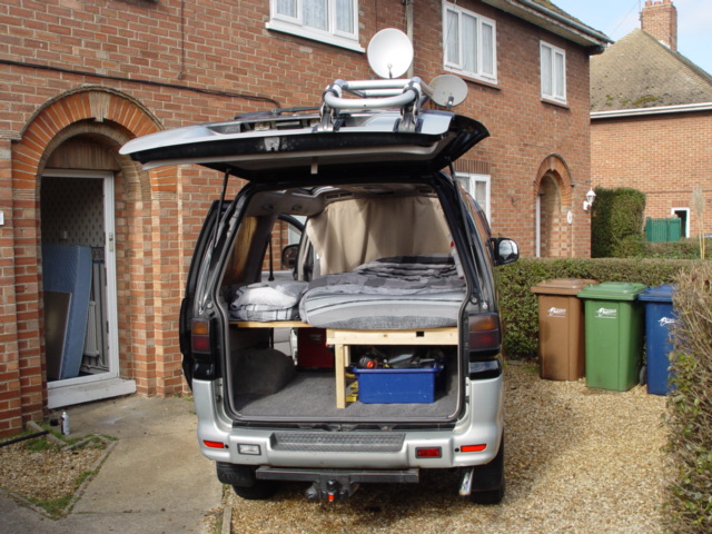

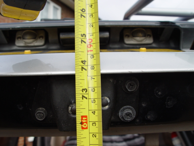

Fitted the struts today and the extra 20mm of strut length equates to an extra 20cm of tailgate opening height.
Before
Before
After
After
The extra pressure means it lifts the tailagate and ladder easily all by itself. :-D
