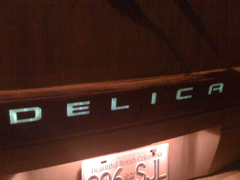

Re: Bulb part# for the rear DELICA illumination. FIXED
Problem Fixed, the GE 891 bulb from Lordco worked great!
