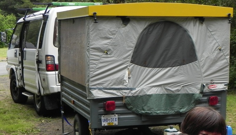

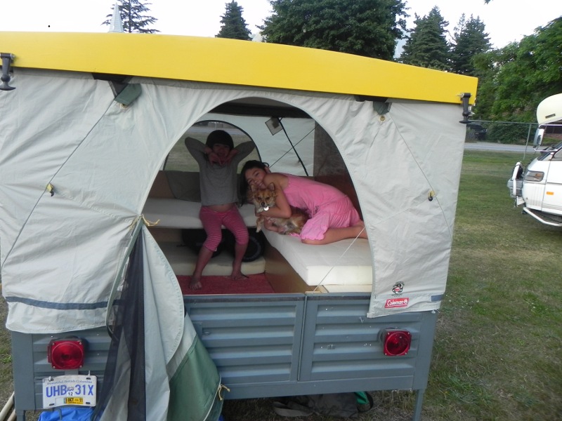

I was set to start building my teardrop, when I decided to gut my 1968 tent trailer and rebuild it as a folding trailer instead. The yellow top, by the way, is skinned with 1/8" plywood over a 1/2"plywood frame - I fiberglassed all the seams and painted it - it's light, bright, and water tight. Right now we all sleep in the trailer, two adults on the floor (mattress) and the two kids on the L shaped cabinets. Ultimately, the plan is to put two in the trailer, two in the van. The fabric ends are a repurposed tent - one day I will have a proper canvas end made.
edit:I hated setting up a tent too, and I don't like sleeping on the ground. This tent trailer is set up in under 10 mins
