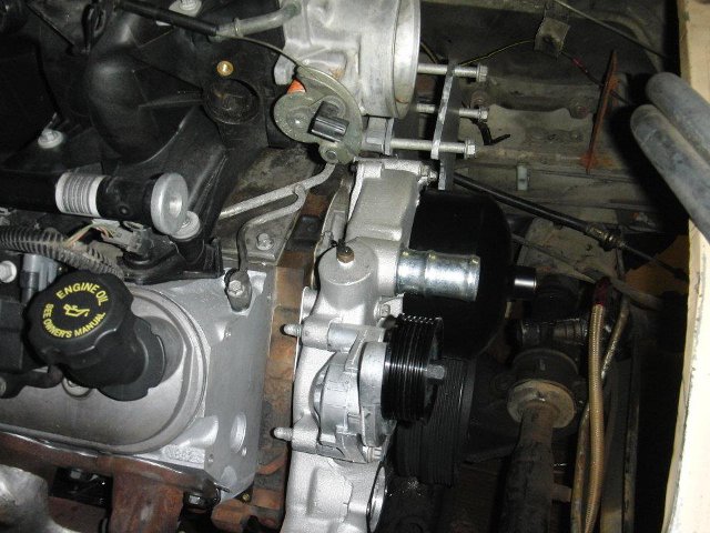

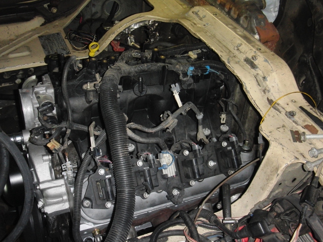

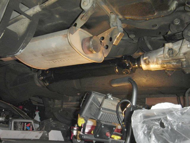

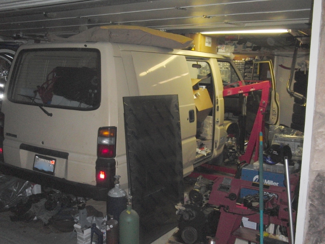

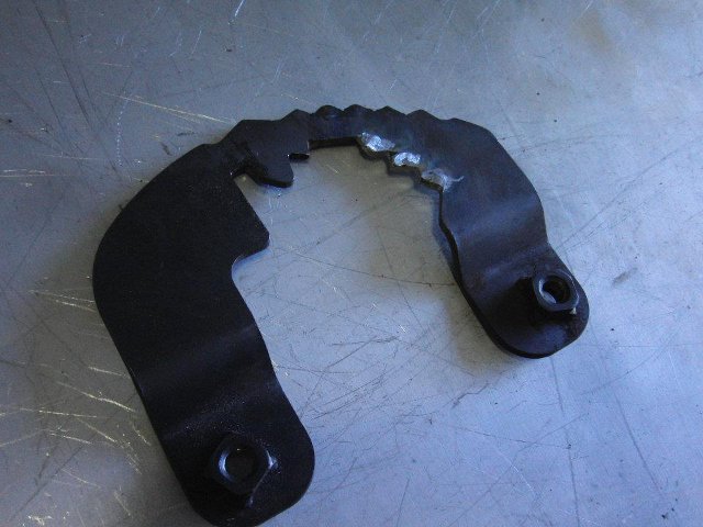

Not dead. Still poking away at this. Hasn't fired yet, but a hell of a lot closer to. First motor I've swapped that I didn't have spare bits sitting on a shelf for. Lots more ordering, spending and waiting than anticipated.
Last weekend.

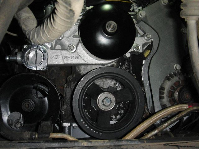

Still need a couple more idlers and a P/S bracket to replace the bailing wire.

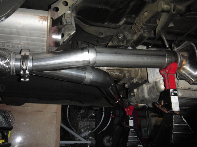

Still need to finish the exhaust.

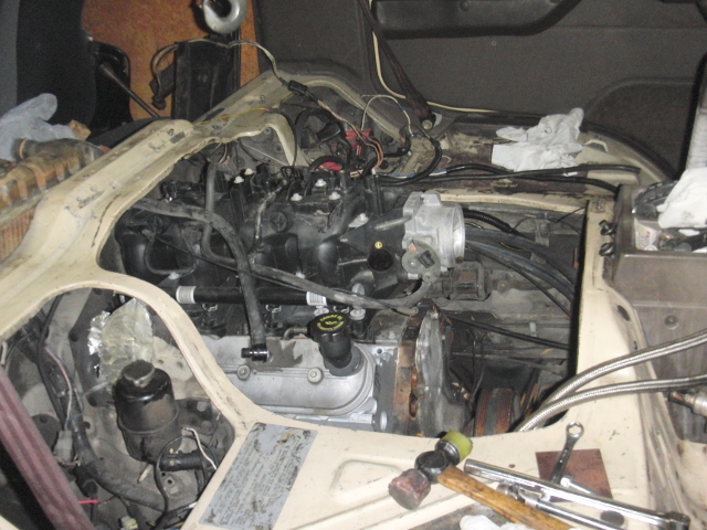

Went in this evening.

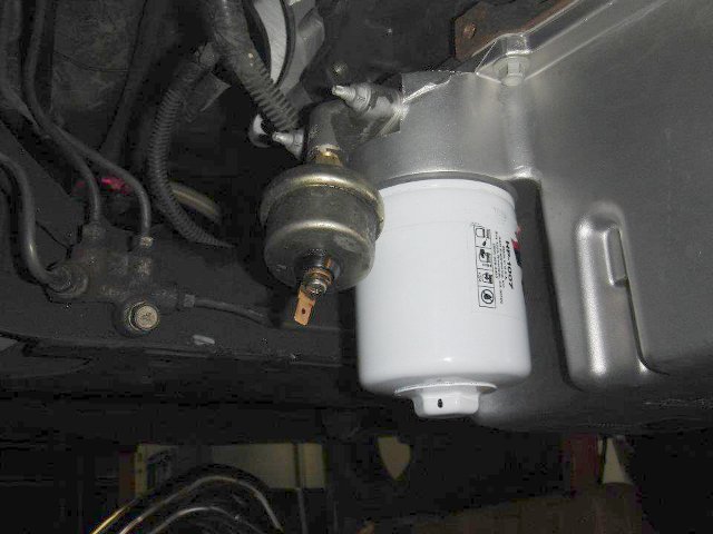

I want to keep the factory gauges, had to find places to mount the Mitsu senders.

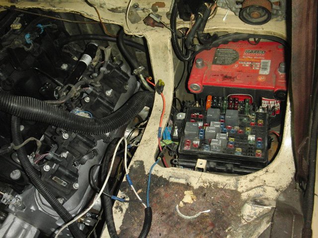

Wired up.

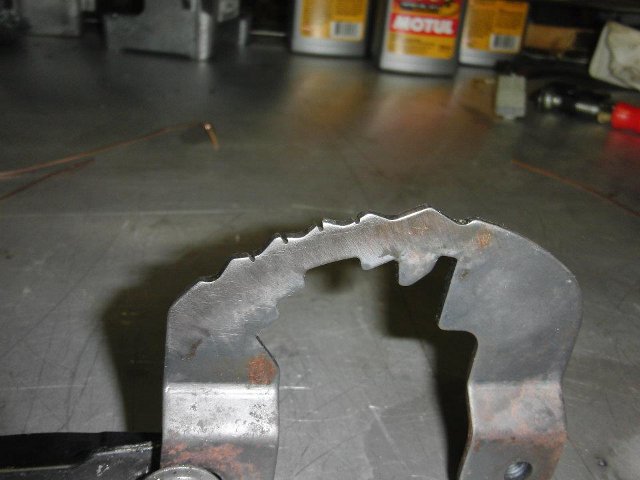

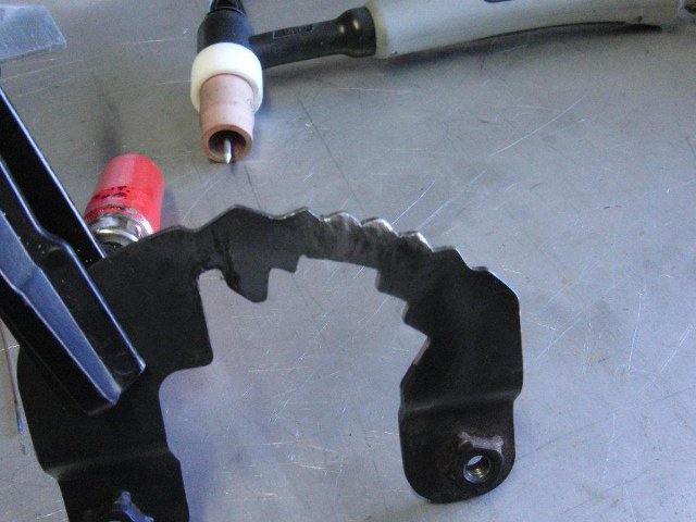

Had to futz with the auto shifter detents to match the GM trans. Cut the new low points, welded material for the new high points and ground it all to shape.
Would like to have it at least running by the end of the month. We'll see.

Dang, can't wait to see this finished, cool project.
Definitely talk to Glen at CC Auto; not only has he attempted a 4x4 conversion, he has a warehouse of Delica parts that would set your van off right!
Cool build pics too, that 8 just fit!!!
