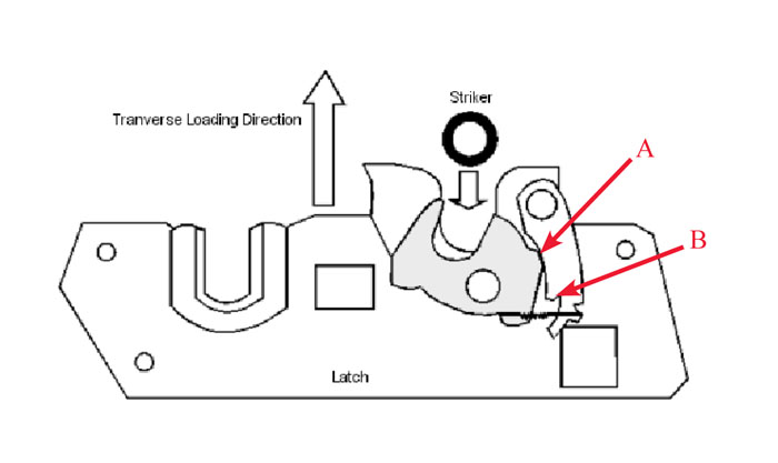

Hi After Oil,
I had this exact problem with a sliding door latch on my Westfalia. I looked around for a detailed diagram of the Delica rear hatch lock but I couldn't find one, so I've attached a generic lock diagram, sorry it won't be correct but hopefully gets the idea across. I'm at work right now, so I can't take photos of mine. So here goes: Internally there should be a hook feature (B) that interacts with a corresponding hook features (A). What I did was remove the lock assembly from the door, put it in the vise, then use a file to 'sharpen' the hooks so that they catch, but not too much or they will stick. After that the door shouldn't bounce back as you describe. Hope this helps.
Tojo

falco: ive adjusted and tightened the part you describe, the male (which is called the striker in Tojo's diagram) and it aint that. its the mechanism for sure. tomorrow in the daylight i guess ill take it apart and try Tojos and Jordans suggestions
