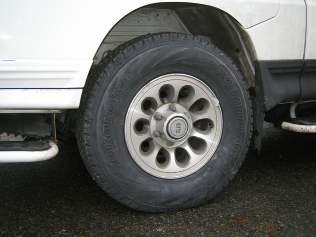

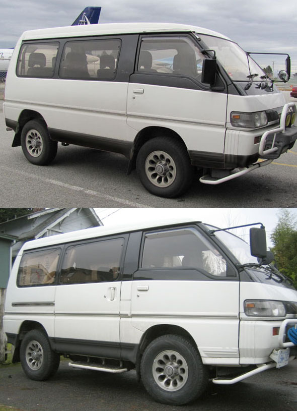

Shaun went to the Spa yesterday and had a pedicure. Well it was Beetle Spa in No. Van. for new rubber. I got a pretty good deal as I have a contact (so I will not quote it), but Rod (@ Beetle Spa) was very good and took care of Shaun.
Above are the tires that came with the van when I bought it.<br />Below are the new Geolander H/T's<br />225 above / 235 below
There is ample space in the wheel well for normal driving. I can't really say too much yet as I only have 30km on them. But I will be driving to Seattle tomorrow so I can related more on handling and gas mileage afterwards. I suspect the mileage will drop a tad. As for handling, I am now ready for the snow ~~ Bring it on!!!
newtire closeup.jpg (63 KiB) Viewed 3433 times

Now that I have several hundred klicks on the new rubber I can offer up a little more.
Yes my gas-mileage has dropped in town. But not by much (Previous got 500-550km per tank / now down to 450-500).
Although the Yokohama's don't feel too aggressive, they do ride harder than the street tires that were on before. I definitely notice the suspension more on bumpy surface (bad BC roads, potholes).
Overall I am happy with the choice. I will be driving to Princeton in the New Year so am looking forward to the off-road capabilities.
