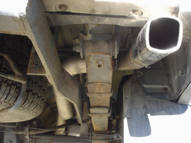

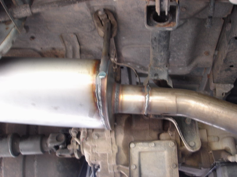

I wanted to get a complete end to end stainless steel exhaust system installed without reusing any of the old exhaust system. Ryan, the owner gave me a few options, and we ended up going with a Flo-pro 18" oval muffler, two sections of mandrel bent 2.5" tubing (not cobbled together with multiple pieces), and a waterjet cut custom flange. I chose a 'squarish' tip that I thought would go with the boxy look of the van. The challenge was to get past my spare tire and trailer hitch without touching or rattling against anything (like the previous pipe did) and exit in the same spot as the stock pipe. I had looked into the side-shooting option, but with kids I needed a quieter pipe.

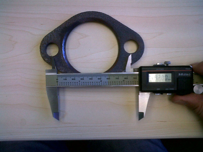

Apparently Ryan says that there is some variation when it comes to the exhaust manifold bolt spacing on the L300's depending on the year. If you have the same spacing as mine, you can fit a 2.5". If you don't, then you fit a 2.25" tapered pipe to the flange and then open up to 2.5" like Fexlboi did here: http://www.delica.ca/forum/another-exha ... -7985.html
I've included a picture of my STOCK flange. It has a bolt spacing of 92 mm and an I.D of 2.476" (62.89 mm).
All in all it was a good experience. I got to check out the mandrel bender, drive the courtesy truck for the day, and pick up my Deli the next morning. How much you ask? Pretty much what I expected for top notch work. PM me if you want to know. More than an aluminized muffler and less than the cost of my laptop! BTW I am not affiliated with this shop in any way!
Surprisingly it is a fairly quiet pipe. Very close to the volume of the stock pipe, but at a different pitch. It has a deeper rumble when you punch it up a steep hill and engage the turbo. The engine feels more responsive, and there is the perception that there is more power, especially rolling on from 70 to 90 kms/hr. As I understand it, the free flowing exhaust allows the turbo to spool up faster, and without back pressure the diesels can 'breathe' and EGT's go down. Maybe one of the experts on the forum knows more on this.

- 92 mm bolt spacing on the STOCK flange
- IMG00253-20111209-1151_sm.jpg (89.88 KiB) Viewed 10399 times

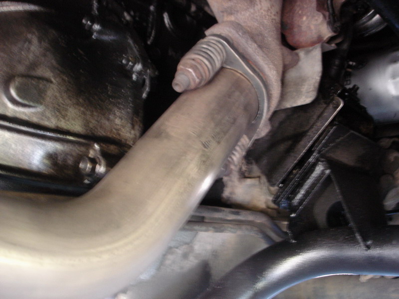

- View of the flange.
- DSC08948.JPG (111.64 KiB) Viewed 10399 times
- And looking up at the tight spaces between the tire and the trailer hitch. There is no rubbing or rattling, and enough space so that the spare tire does not heat up.
- DSC08946.JPG (120.32 KiB) Viewed 10399 times

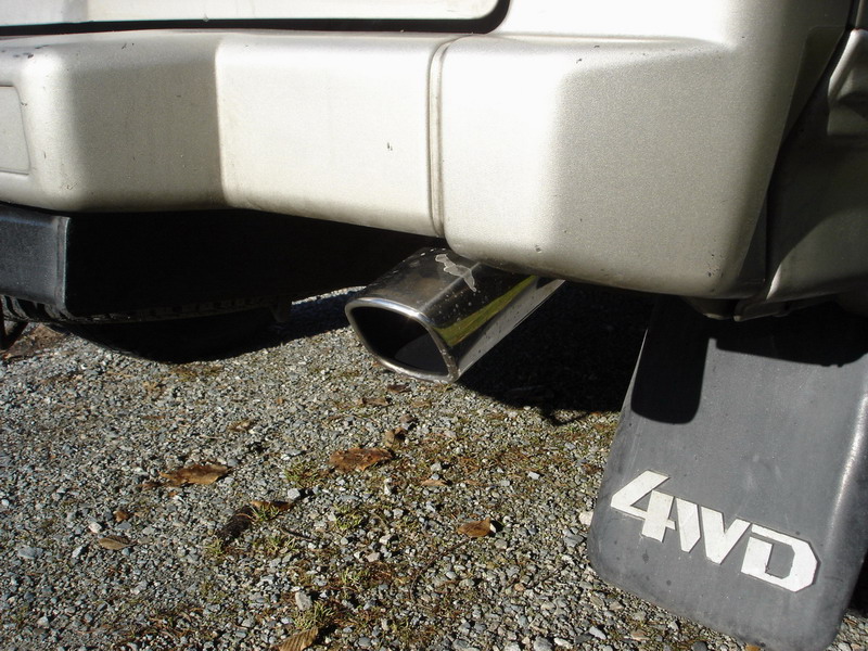

- Here is how it looks from the back
- DSC08945.JPG (185.38 KiB) Viewed 10399 times

Stainless tubes $185.00
Custom flange $35.00
Flo-pro SS muffler $119.00
Stainless magnaflow square tip $39.92
Hangers $25.80
Labour $761.25
Shop supplies $59.36
Exhaust donut $18.00
Subtotal $1243.33
Total incl. tax $1392.53

As no one seems to make Mandrel Bent in Quebec City, can a Delica ownwer in a need for a new muffler get in touch with me before going to Muffler Tech: I would ask you to duplicate the Flange AND the first Mandrel Pipe Tubing that will be soldered to it (Picture DSC08948 above). Of course, will pay my parts and shopping overhere !
