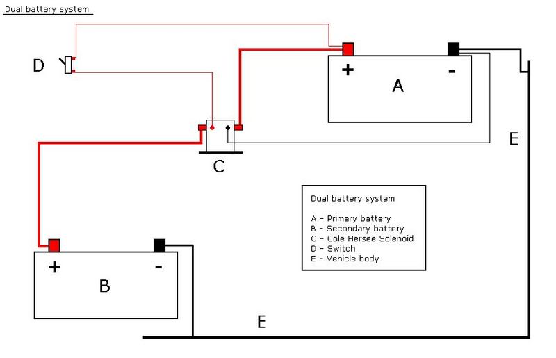

This is a diagram of how to hook up the battery isolator, from 92Pajero:
- dual_battery.jpg (25.04 KiB) Viewed 8067 times
Re: Battery isolator
I could wire my isolator up the exact same way!
Question is, where did you get the switch from since it has to handle the CCA's of the battery does it not? What gauge wire did you use too?

all the switch should have to do is energize a low current coil which closes the main contacts in a relay which carry a high current. a switch should never have to carry full load current if wired properly. most switches should handle up to 10 amps. your cranking amps are 2-300 amps. minimum wiring should be at least 4GA for the main battery connections, 2ga is better. the switch wiring can be 14-16 ga. it depends on what the relay coil is rated for to energize.

The relay is rates for 200A. I was told 100 was a minimum. I'm not entirely clear on how any of this works so I may have to pick Jay of Tardisdeli's mind a bit.
The isolator looks to be the same set-up as the relay shown above which boosts my confidence in the ability to make what I have work.

Gentlemen the switch in the diagram in this thread only has to handle 12 volts and no CCA since all it does is signal the solenoid to "close" and let the battery current travel. A ford solenoid as such in the diagram can handle a crap load of CCA since it handles regular battery CCA going through it. I used 16 guage wire for my switch and the ground running to the solenoid and I never use less than 4 guage for the battery connections and large solenoid connections, if possible 2 guage is preferred. One thing I forgot to add is that I run a 20 amp inline fuse between the switch and solenoid, just incase you ground out the wire someplace and don't wanna melt anything. If anyone has any questions gimme a shout and I will see if I can help out. By the way if anyone out here needs the glowplug relay/solenoid that Rising Sun is selling for 170 I can get an awesome deal on DENSO replacements for around 96 bucks taxes in.

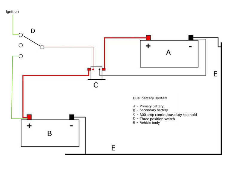

From Jay:
- A setup with a 3 position switch
- Use a 300 amp continuous duty solenoid such as Blue Sea BSS 9012 http://bluesea.com/products/9012
- dual_battery_with 3 position switch.jpg (51.31 KiB) Viewed 7794 times
Looks like I'm still out of luck with my 200 amp isolator.
Nice drawing though, thanks for sharing!
