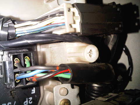

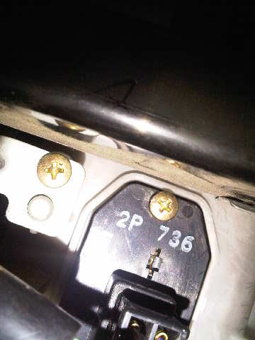

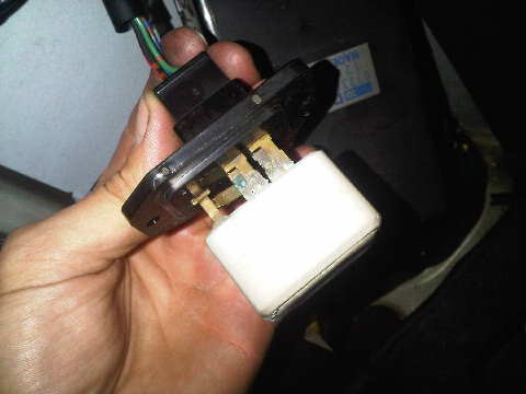

Hey we all seem to have that issue. I do have info on the rear heat issue. If you have a LWB you most likely have two A/C units. One for the front and one for the rear. Believe it or not you can be running A/C in the rear and heat up front and vice versa. I guess if you did that it would aid in dehumidification in the summer in a humid (Japanese coastal) climate.
You will notice in the rear you run heat from the bottom vent under the seat however you have no heat out of the ceiling vents. If you remove the cover on your A/C unit located behind the drivers side rear jump seat in the back you will also notice that the upright on that side is larger then the other side. This is because it acts as a main duct feeding the ceiling vents from the A/C unit you removed the cover from.
There is a 12V ceramic heater located downstream of the fan and A/C unit in the duct. Its a little and strange looking heater when removed. Mine heats up but very slowly and not very hot. I notice my air out the top vents is cool. Never cold but also never hot. This heater has seen better days but good luck finding a replacement. And making a Canadian Tire 12v heater fit would be asking for a car fire. Bets bet is if you want heat in the back just run the floor vents.
As for the center vents I don't know why they are not heating. On my owner manual (in Japanese) the vent layout shows these vents are all part of the main system in the front. Why they don't heat? (Possibly because it could overheat the instrument panel or it is intended for fresh air supply only) or there is another strange little ceramic heater beneath the dash I don't know about) all I do know is that I learn to live with the rear ceiling vents not running heat and I shut off the centre vents.
Oh and clean your rear A/C units removable washable filter.

- IMG-20111208-00175.jpg (34.94 KiB) Viewed 3511 times
- IMG-20111208-00174.jpg (29.91 KiB) Viewed 3511 times
- Heater in its place.
- IMG00687-20110921-1826.jpg (35.5 KiB) Viewed 3511 times
- IMG00688-20110921-1826.jpg (23.06 KiB) Viewed 3511 times
- Ceramic Heater.
- IMG00685-20110921-1819.jpg (15.6 KiB) Viewed 3511 times
