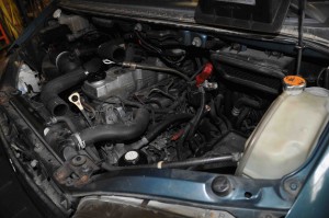

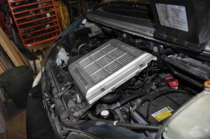

I have the Delica parked in my shop, have popped the hood and taken my first look.
Talk about a lot of stuff packed in a small space! I removed the intercooler and the battery and things already look better.

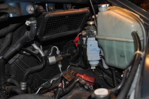

I can kind-of see the fuel injection pump to the right side of the motor (looking into the engine compartment from the front of the van), and I have identified the diesel fuel filter tucked into the far right side of the engine compartment. I have also identified a number of coolant lines. I am now at the point where I am hoping to get a few questions answered:

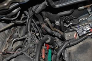

- Does anybody know where the coolant lines are going through the wall separating the engine compartment from the passenger compartment on their way to the van's heater or how to identify these lines?
- How much more 'stuff' should I remove to get access to the injection pump, and more importantly the fuel line feeding into it? I want to tee into the fuel line as close as possible to the actual pump, but I am a little nervous about pulling something and then having to re-install it later. Is there a shop manual that is available for these vans?
- Where have other people teed into the fuel line?
