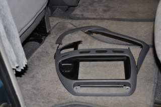

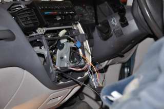

New Delica owner. We removed the Japanese radio and discovered the vinyl had already been broken. Then Chris, my husband, wrecked it completely. Photos below of what we are looking for...and general advice about where to find stuff like this...thanks.

Bummer. That piece is like $200+ new
Any of the usual Delica dealers should have them instock since they are an easily broken item.

Just fix it. Glue it together well - use epoxy and build up the seams on the inside. Take your time to find ways to "clamp" it together so the fit is good and the original lines are intact. Be patient. You might try taping the glued piece down to a supporting structure made of cardboard.
Once you have restored the structure, fill any gaps in the face and sand out the whole thing (by hand, take care) right up to a really fine grit. Prime it and paint it. You'll probably want to mask out the black parts and the clear display.
Color match or just make it another color you like that will make your van original.
For $280 this is totally worth it.

you can easily fix that one looking at the pictures. The main body is intact.
Do as RichD suggests and you'll save yourself $280. You'll need between $5-15 of epoxy/sandpaper and touch up paint.

Yes, I am thinking I will try to fix it myself. The tabs that lock it in place, though, are broken off. These are the parts that the previous owner broke. We discovered this when we were removing it. I'm pretty sure the little tabs are gone...perhaps they are not really needed?

You don't need all of the tabs but that plastic is super brittle and when you rebuild you have to fill every cavity you can on the back

So, ove last several weeks I've slowly been glueing pieces together. So far there are 17 separate joins. I've been letting the joins cure 24 hours before starting new ones, so it has been slow. Today, as I was doing what I thought was the last join, I made two more breaks. A piece I was trying to glue back in place literally crumbled in my fingers. I've stuck them all back together again but I'm not optimistic of our chances of even sliding the darn thing into place without breaking something. So I guess I'm going to start looking for a new one! Problem is we leave in a few days on our trip...so I'm going to have to look for something along the way or in Ontario. Yeesh.

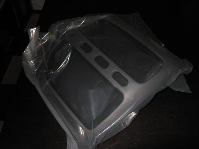

If you have 2-3 broken pieces, it may be worth to fix.SandraBurkholder wrote:So, ove last several weeks I've slowly been glueing pieces together. So far there are 17 separate joins. I've been letting the joins cure 24 hours before starting new ones, so it has been slow. Today, as I was doing what I thought was the last join, I made two more breaks. A piece I was trying to glue back in place literally crumbled in my fingers. I've stuck them all back together again but I'm not optimistic of our chances of even sliding the darn thing into place without breaking something. So I guess I'm going to start looking for a new one! Problem is we leave in a few days on our trip...so I'm going to have to look for something along the way or in Ontario. Yeesh.
But I think there's no way to put 17 pieces together.
There are almost nothing used one in the market.
As a dealer we have 1 of 3 L400 has had a broken center console, so we most likely import and replace them with new ones.
Try a new center console and make it nice and neat.
