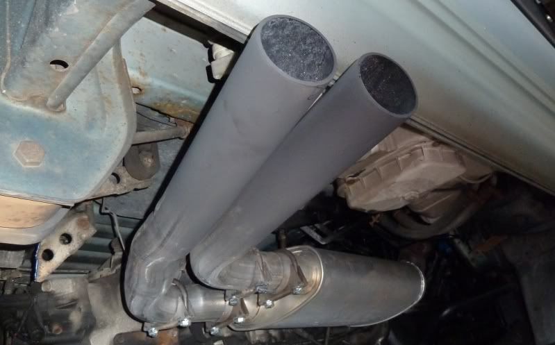

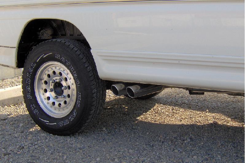

Well, did this just prior to my previously posted mishap of wrong fuel... but wanted to nevertheless post some pics of my new dual side exhaust.
- The Van sounds way better... there is a constant bit of turbo-whistling...
- You can really hear the turbo spooling up when stepping on the gas
- I extended the tail-pipes just enough beyond the side of the van (maybe an inch or so) that the rear wheel doesn't get too black from the soot
- The Delica has a small but noticeable power increase - this leads to the tranny kicking down earlier on the uphill (I need to change this)
- With the old exhaust I would reach approx. 110kph at 2'900 rpm... now I reach 120kph at 2'900 rpm...
- Fuel economy is about the same (maybe I step on it a bit more, because there is a bit more punch to take advantage of)
- With some of the other Deli's I saw with side-pipes, I noticed tail pipes are positioned pretty low - about half way between body of Van and road
- I didn't like this and asked muffler shop to mount tail pipes higher... they are about 1.5 inches below body of Van
- Entire system cost me $ 350.00 at a muffler shop in Port Moody
- Spray painted exhaust tips with black high-temp spray paint...
- Very happy with the new system...

impalator wrote: - With the old exhaust I would reach approx. 110kph at 2'900 rpm... now I reach 120kph at 2'900 rpm...
Looks good...not sure how exhaust effects highways speed unless with the old exhaust it the throttle was so open that it stayed out of OD???
impalator
Posts: 309
Joined: Sat Sep 06, 2008 7:58 pm
Vehicle: L300
Location: Tri-Cities
Re: New dual side exhaust...
Post by impalator »
@thedjjack... good point, I have no idea how the exhaust/backpressure/gas-flow/transmission/highway-speed ratio and dynamics work... but it is a fact... I was 10 kph faster at the same RPM than I was before...
I talked with Jay and Christine from Tardisdeli and Jay had told me about his observation that their Van was doing about 10 kph more at same engine revv's after they had installed a free-flow side-dump exhaust on their Tardis-Deli...
I never had it stay out of Overdrive... in fact I have had my own Overdrive saga that I posted about on the forum about a year ago - but this is all fixed and not an issue anymore... However, without overdrive you would never reach 120kph (certainly not on my Van) and certainly not at 2'900 RPM...
No idea how it works - but it works... :-)

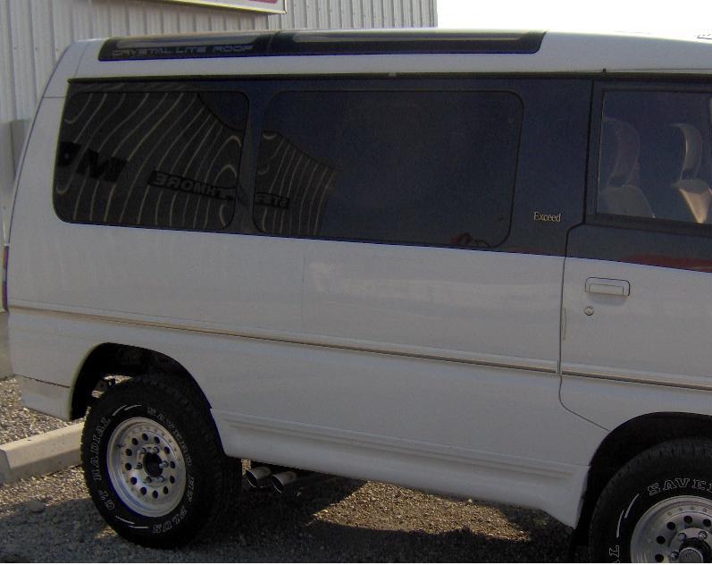

I like the looks of impalator's dual side exhaust and am going to upgrade mine soon. Looking for opinions on what people have found to perform the best, look the best, sound the best and one other thing I'm working to avoid is the back of my white van and the white trailer I pull being covered by soot. Not looking to run a stack up the back of my van either! 8-)

This is what I ended up doing after being inspired by impalator's exhaust. New paint is next on the agenda.
