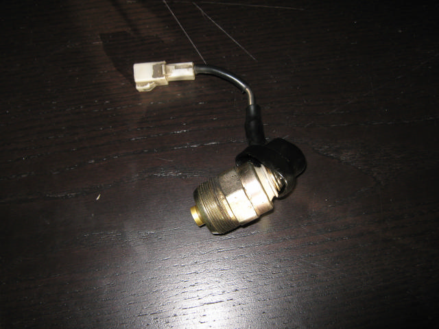

I think you are talking about injection pump solenoid like pic.Orionsbelt wrote:I did come across this helpful tip around forcing an engine shut off...That said I thought the IP was in the engine...where is this button.
http://www.pocuk.com/forums/viewtopic.p ... 756947a877
I'm still thinking this is electrical but just in case I get it going again this morning BUT if it decides not to shut off again maybe this button on the injector pump will work.
Anyone?
If gone, no shut off or no start.
Steven
- IMG_1894.JPG (89.61 KiB) Viewed 5879 times
