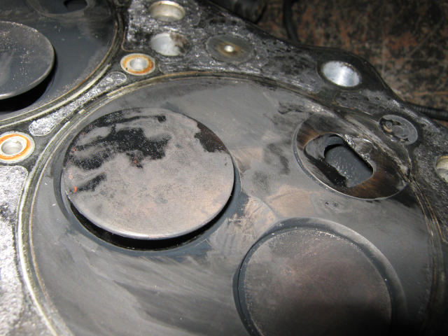

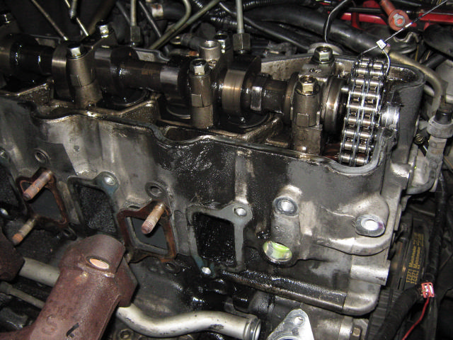

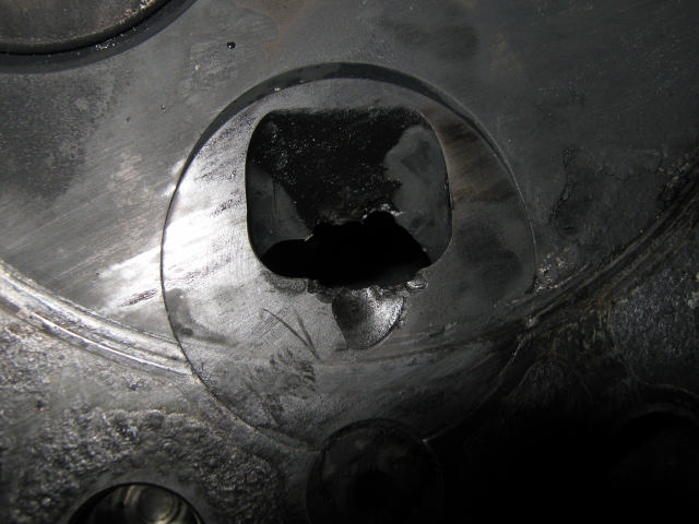

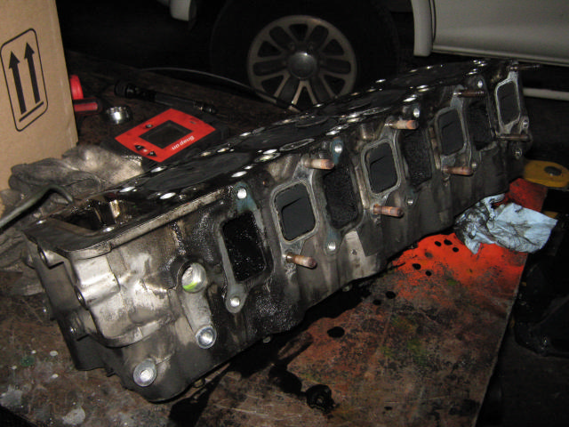

Could be a cylinder head ( valve, valve seat ) and IP damage.
Very high possibility. too bad.
Open the head, and all check surfaces for crack/broken.
If you have a broken cyinder head, you may need a IP complete rebuilt.
We have done this job a 2 weeks back.
Steven :-(

We had a customer who accidentally put $60 gasoline in the fuel tank ( L400 ) while receiving a call.
He drove appro.20km, and apparently felt bad around 1500-2000rpm with engine stall and strong smell. Also he had a late start problem ( still running ).
After lots of checking/inspection, it ended up cylinder head damage, IP seizure and full fuel line damage.
It cost him over $4,000.
It could happen.
Steven :M
