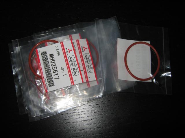

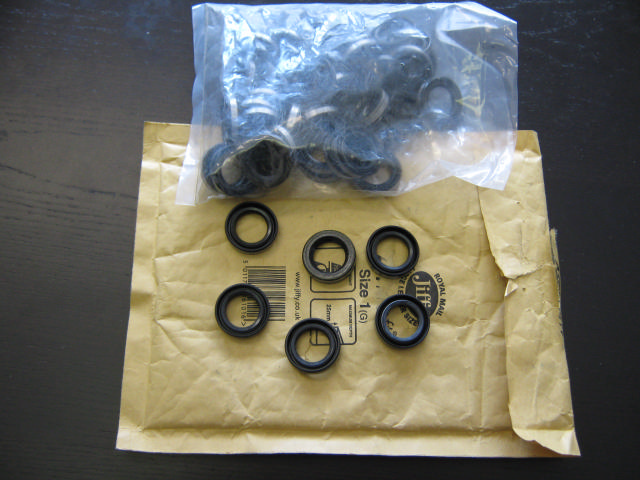

There are several key O-rings/oil seal that should be replaced when rebuilding IP.
1. IP governor O-ring
**cover on top of IP
2. IP head O-ring
3. Accelator O-ring
**inside the governor, common leaks from this area.
**easily worn out as mileage build up
4. Timer O-rings_ 2 spots
**worn part went flat as they are leaking
** common issue
5. IP main seal
**If worn, no pressure develops and air goes in fuel system
**main cause for starting delay/issue
When you have a IP rebuilt service, you’d better get full rebuilt instead of replacing main seal only.
To replace a main seal ( with 2 O-rings ) only may cost you from $500.
Steven 8-)

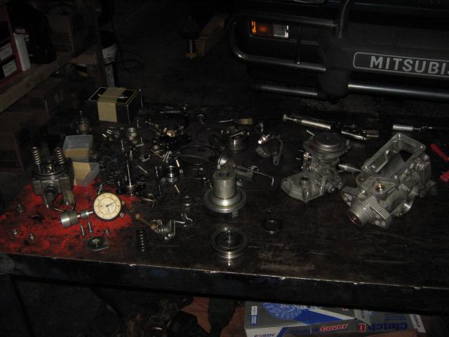

I did the dreaded IP seal about a month ago in my wife's L400. She had the usual stalling issues for a few months before I decided to take a stab at replacing it. I bought an entire bosch seal kit of ebay for $27.00. Her van only has 85K on it so I decided to just do the one seal and any others I deemed easy to replace. I really took my time, cleaned every part while it was out. Total time was around 6 hours. Timing is slightly advanced now so I've got to spend another hour or so to pull it back to where i want it, but it started instantly and hasn't let her down since. Not the easiest job but very rewarding. Saving $500+ doesn't hurt either!
