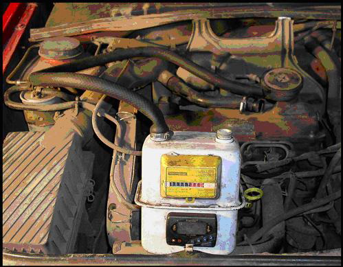

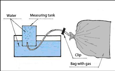

- Profister
- Posts: 963
Re: I'm stumped
Strada-caster:
The best way to check 'the rings' theory is to measure the gas flow coming from the vent hose The pressure test is useless when it comes to the issue like this; there is enough liquid in the pistons to seal the gaps. Ideally you need a rotameter and the numbers to compare the readinds with. I am not sure about your engine but the numbers for a 4M40 are as follows; anything under 20 L/min is excellent, 20-40 L/min is fair and readings above 50 L/min will tell you that the piston rings are not working properly. One of rotameter examples is a household gas flow meter. There are some tecniques you can use without a rotameter; the picture below is showing the idea. Collect the vent gas into a plastic bag for 1 minute and push it into the measuring tank. On the second picture you can see how to use a household gas flow metering device. There might be some other ways of doing it in your home garage but don't rely on a pressure test.
- Rotameter2.jpg (50.26 KiB) Viewed 9056 times
- Rotameter.jpg (70.73 KiB) Viewed 9056 times
