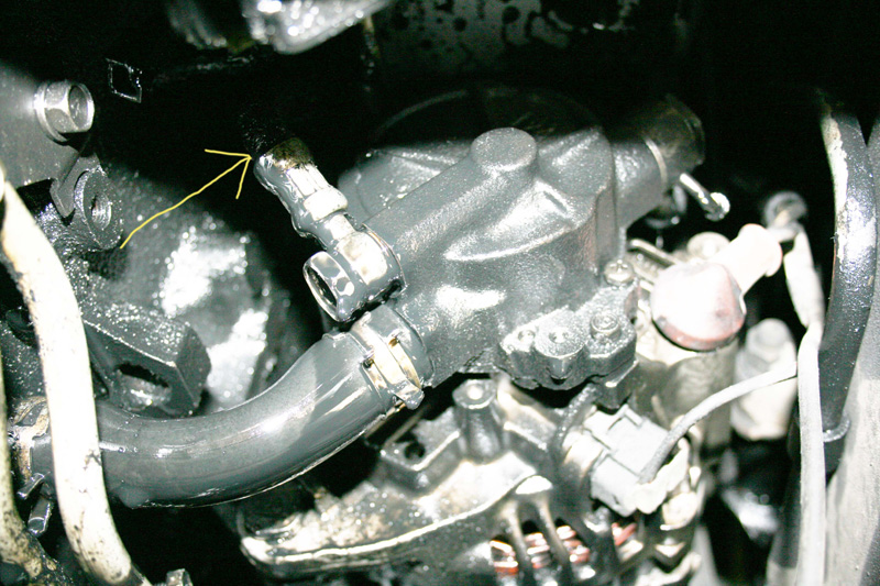

I seem to have an oil leak in one of the hoses coming from my vacuum pump.
I started the van up yesterday and oil just came squirting out.
I am not a super-do-it yourselfer but it looks like I can just unbolt this hose and reattach a new one. I am assuming that draining oil would be involved in this.
That I would be comfortable with.
I deal with CVI in Richmond and live in Maple Ridge so I think the towing cost would be extreme.
Does anyone know the part number for this hose?
I have attached a picture to make sure I am correct about the vacuum pump part.

dont know the part number, but you might be able to get one used from one of the dealers. be sure though that its that house and not something above it like the turbo.
its not a hard hose to swap, go ahead and change your oil at the same time, since youll be draining it. or you could just drain from the hose into a container. if the engine is cold, most of the oil will be down in the oil pan anyway.
wear gloves and have plenty of rags handy, and maybe even put down some cardboard in case it get a little messy

Not a lot of oil will come out when you remove it, just take it off and go to an industrial/hydraulic hose place and see if they will make one up, they are often quite helpful.

that is the oil feed line from the engine block
it's a female to female hose with a banjo bolt on either end.
If you remove it and take it into Lordco or Canadian Tire, they should be able to match it up as it is not a high pressure line.
Failing that, pickup a new/used one from one of the JDM guys.
Take Ari's recommendation to look for an oil leak from above either at the turbo or at the opposite end of the hose at the block.
Hard to tell from the picture but it looks like there is a hairline split when the hose is crimped which would require a replacement.

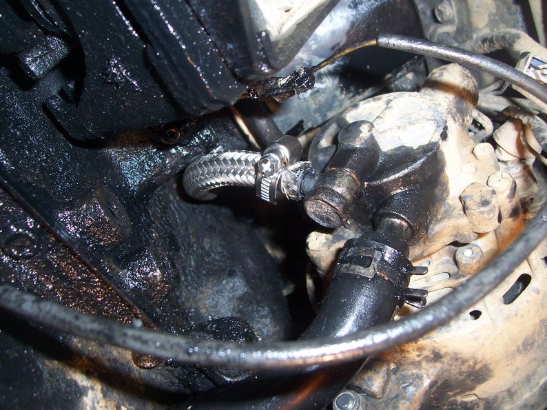

Hello everyone, I had the same problem, I solved it temporarily and economically in this way
