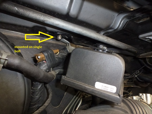

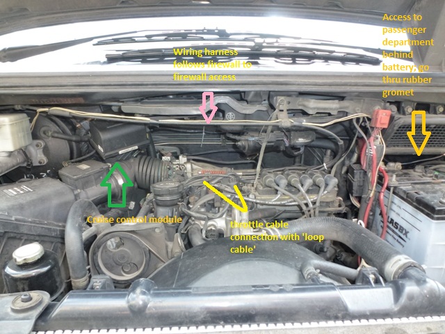

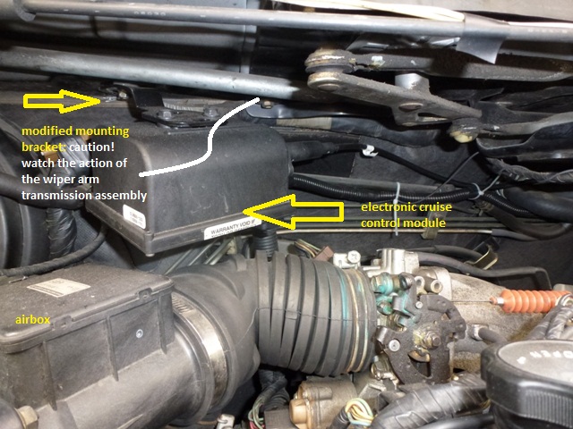

The mounting of the electronic module went under the bonnet, next to the airbox up under the overhang. The supplied mounting bracket was modified - cut - removing about 8cm off (left 2 holes in the mounting bracket) to permit bolting into position. Take care to bend/shape the bracket to permit the bracket and module to be out of the eliptical movement of the windshield washer transmission.
Wiring harness passed along the length of the firewall behind all the tubes and wires to the firewall hole in the footwell of the passenger (left) side. Wiring then follows inside the firewall to the steering column. There is plenty of wire in the harness and it is nice to have a convenient way to deal with all the excess wire.
Wires: Brake hot and cold are easy to find with a circuit tester. TACH wire and Speed Sensor wire connected BEHIND the instrument cluster. When you remove the instrument cluster, you will see on the back side symbols TA (tachometer) and SP (speed). Using 16GA round ended wire clip you can screw the Tach and Speed wires to the back of the instrument cluster.
Ground is done inside the engine compartment at a convenient place. Power is clipped into the fusebox at a KEY ON live source.

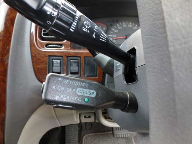

The cruise control switch mounted on the steering column below and forward of the gear shift and windshield wiper stalks to ensure clearance.

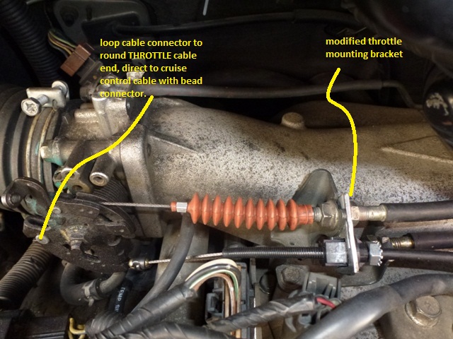

Throttle Cable Connection:
The cruise control cable is connected to the throttle cable with the WIRE LOOP connector. Because, also, there is MORE than 41mm of throttle movement i could attach the cruise cable to the throttle cable direct with the bead connector (ie no other beads for lengthing necessary). The bead connector is ziptied to the throttle cable to keep it inline and not bound up.
Furthermore the cruise control cable is placed in line by a modified cruise control cable mounting bracket supplied with the kit. I cut the mounting bracket to ONE bolthole and the SQUARE slot to permit clipping in the supplied clip. The one bolthole side of the mounting bracket is connected to the passing cable kickdown mount. see pics
