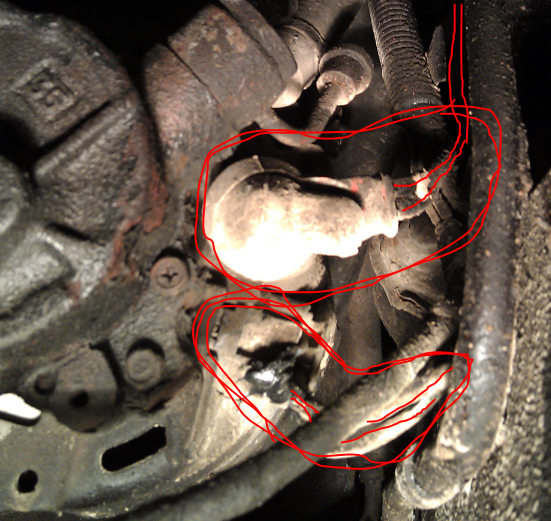

I want to hook up a RPM gauge/tachometer to my L300, (didnt have any from factory).
My problem is that i don't know where to get the signal from, is it possible to use one of the alternator leads, if so, which?
If i look at the alternator from under the car, it looks like this (see pic). What are the leads i made a red ring around?

Where is the original tachometer connected?

OK, i tried all the wires comming from the alternator, non of them gives a tachometer signal.

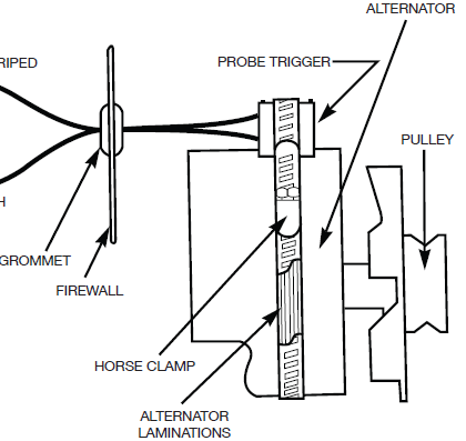

I also have same problem, but according to the sources i found in the web it should be connected to the alternator in the diesel engine and it should connect to the distributor when engine is gasoline. In one article there is a probe they mount in to the alternator to get the RPM signal.
What about instillation manual come with your new RPM gauge?
If you could resolve please update....
Check the below image..
