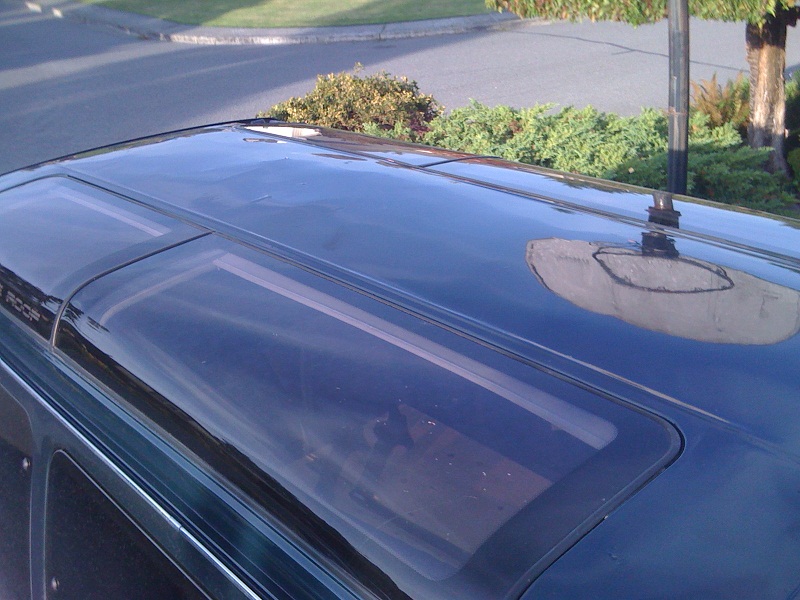

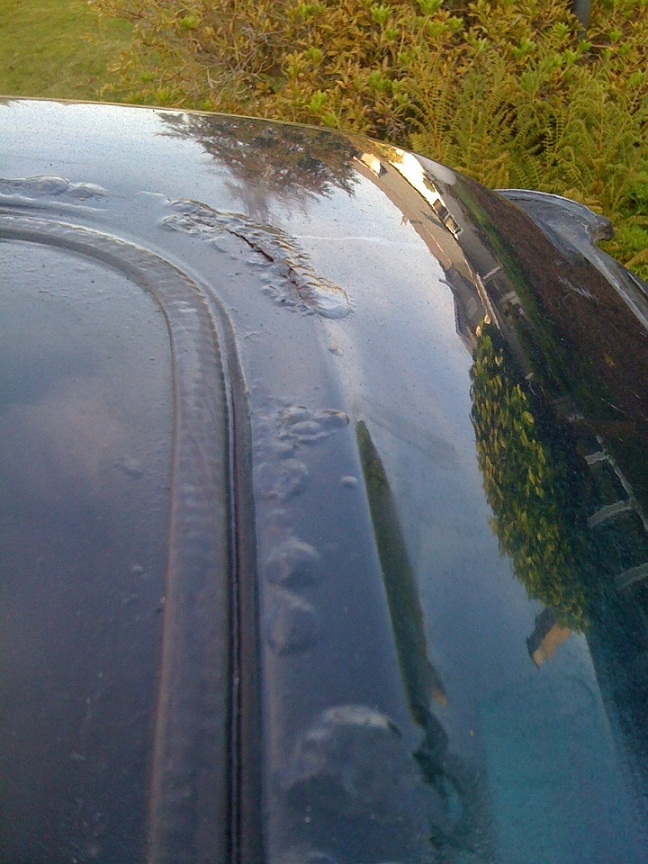

This past week I finally had time to get to rhino lining my crystal lite roof. It seems like a few people on these forums have rhino lined their crystal lites, but there doesn't really seem to be any pictures of the before/after process out there that I could find (except for someone who posted their non-crystal lite roof). Anyways, I thought this may be a useful post for anyone who is thinking of doing this job. My roof was in dire need of some fixing. You can see in the first couple pictures below that the rust was getting pretty bad, especially around the front skylight:
Its a bit harder to tell in this picture, but there are a few small cracks and bumps up the middle. Overall, not very straight at all....

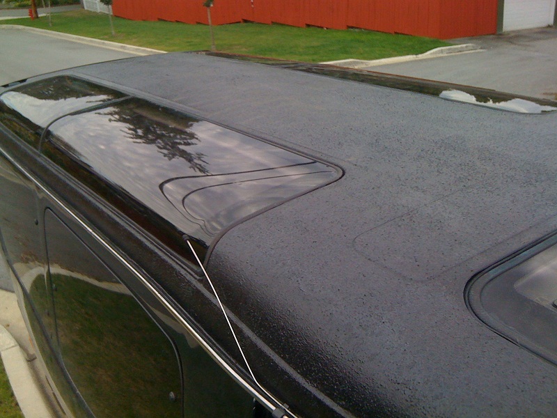

So for those who are interested in doing this - here's what the finished product looks like!

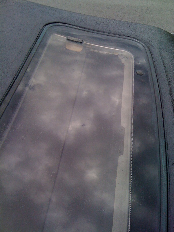

If you compare this shot of the sunroof with the picture at the top of this post you can see it's night and day
Much smoother roof now! (there's a few lines that look like ripples, but its just from having a tarp over the roof for a couple days in the rain! (it started raining the day after I painted it, and it takes a few days to fully cure, so I figured I should cover it with a tarp)

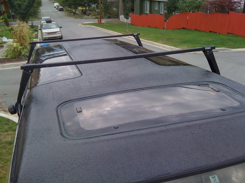

Finally, with the roof racks back on
