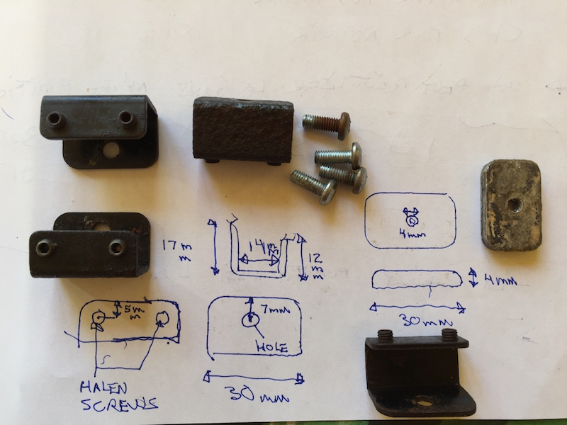

I have the spoiler sitting in the garage, got it with the bus, but I don't have any of the mounting hardware.
Not sure if anyone has bits sitting around of if it is something I can fabricate on my own.
Any help would be much appreciated!

if you dont find a bracket, you can use polyurethine to attach it on to the roof. i did that in one delica and held pretty good.

Here it is :o
